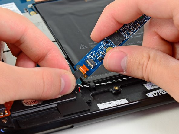

  11. HP TouchPad Digitizer Control Board Replacement, Digitizer Control Board: crwdns2935265:011crwdnd2935265:01crwdnd2935265:01crwdne2935265:0
    • Remove the two 3.0 mm Phillips screws securing the digitizer control board to the rear case.
  12. HP TouchPad Digitizer Control Board Replacement: crwdns2935265:012crwdnd2935265:01crwdnd2935265:01crwdne2935265:0
    • Lift, but do not remove, the digitizer control board out of the rear case.
    • Do not try to completely remove the digitizer control board yet, as it still remains connected to the motherboard by the digitizer control board ribbon cable.
  13. HP TouchPad Digitizer Control Board Replacement: crwdns2935265:013crwdnd2935265:01crwdnd2935265:02crwdne2935265:0 HP TouchPad Digitizer Control Board Replacement: crwdns2935265:013crwdnd2935265:02crwdnd2935265:02crwdne2935265:0
    • Using the edge of a plastic opening tool or your fingernail, carefully flip up the retaining flap on the digitizer control board ribbon cable ZIF socket.
    • Pull the digitizer control board ribbon cable straight out of its socket on the digitizer control board.
    • Remove the digitizer control board from the TouchPad.
