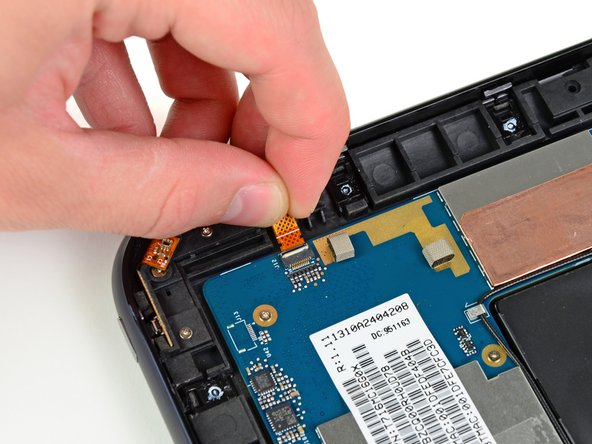

    1. HP TouchPad Control Button Assembly Replacement, Control Button Assembly: crwdns2935265:011crwdnd2935265:01crwdnd2935265:02crwdne2935265:0 HP TouchPad Control Button Assembly Replacement, Control Button Assembly: crwdns2935265:011crwdnd2935265:02crwdnd2935265:02crwdne2935265:0
      • Use the edge of a plastic opening tool to flip up the retaining flap on the control button cable ZIF socket.
      • Pull the control button ribbon cable straight out of its socket on the motherboard.

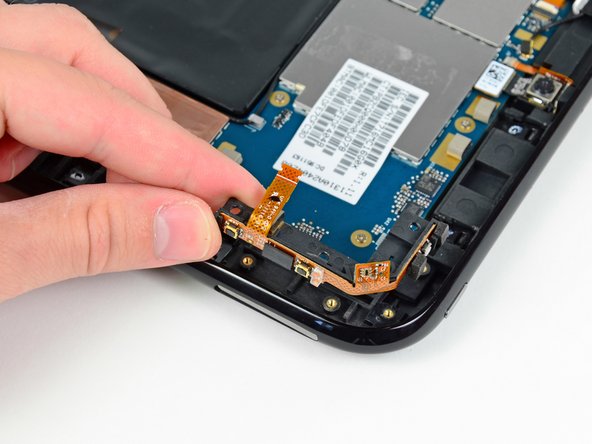

    2. HP TouchPad Control Button Assembly Replacement: crwdns2935265:012crwdnd2935265:01crwdnd2935265:01crwdne2935265:0
      • Use the edge of a plastic opening tool to peel the ambient light sensor off the body of the control button assembly, revealing a hidden screw.
    3. HP TouchPad Control Button Assembly Replacement: crwdns2935265:013crwdnd2935265:01crwdnd2935265:01crwdne2935265:0
      • Remove the following four screws securing the control button assembly to the rear case:
      • Two 3.1 mm Phillips screws
      • Two 2.7 mm Phillips screws
    4. HP TouchPad Control Button Assembly Replacement: crwdns2935265:014crwdnd2935265:01crwdnd2935265:02crwdne2935265:0 HP TouchPad Control Button Assembly Replacement: crwdns2935265:014crwdnd2935265:02crwdnd2935265:02crwdne2935265:0
      • Use the edge of a plastic opening tool to lift the control button assembly up from its housing in the rear case.
      • Remove the control button assembly from the TouchPad.
