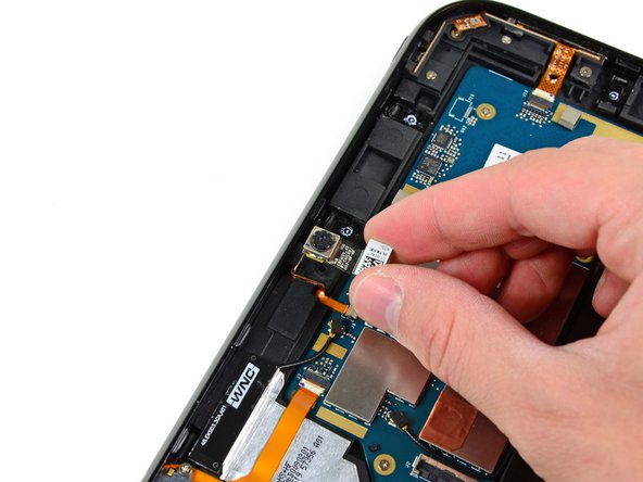

  11. HP TouchPad Camera Replacement, Camera: crwdns2935265:011crwdnd2935265:01crwdnd2935265:01crwdne2935265:0
    • Use a plastic opening tool to pry the camera connector up and out of its socket on the motherboard.
  12. HP TouchPad Camera Replacement: crwdns2935265:012crwdnd2935265:01crwdnd2935265:02crwdne2935265:0 HP TouchPad Camera Replacement: crwdns2935265:012crwdnd2935265:02crwdnd2935265:02crwdne2935265:0
    • Wedge a plastic opening tool underneath the camera and carefully pry upwards to dislodge it from its recess in the rear case.
    • Lift the camera out of the rear case.
