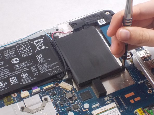

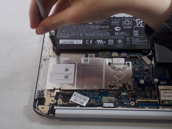

  5. HP Stream x360 11-p015wm Battery Replacement, Battery: crwdns2935265:05crwdnd2935265:01crwdnd2935265:03crwdne2935265:0 HP Stream x360 11-p015wm Battery Replacement, Battery: crwdns2935265:05crwdnd2935265:02crwdnd2935265:03crwdne2935265:0 HP Stream x360 11-p015wm Battery Replacement, Battery: crwdns2935265:05crwdnd2935265:03crwdnd2935265:03crwdne2935265:0
    • Use the JIS J1 screwdriver to remove the 6.5 mm screws surrounding the battery.

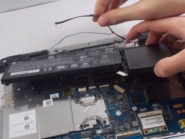

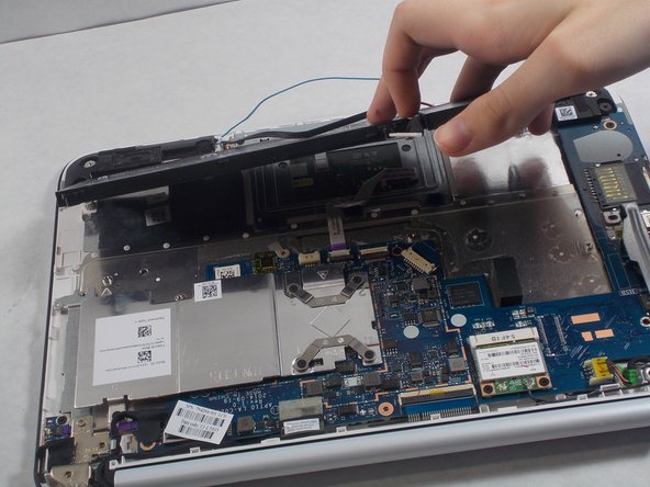

  6. HP Stream x360 11-p015wm Battery Replacement: crwdns2935265:06crwdnd2935265:01crwdnd2935265:03crwdne2935265:0 HP Stream x360 11-p015wm Battery Replacement: crwdns2935265:06crwdnd2935265:02crwdnd2935265:03crwdne2935265:0 HP Stream x360 11-p015wm Battery Replacement: crwdns2935265:06crwdnd2935265:03crwdnd2935265:03crwdne2935265:0
    • Using the iFixit tweezers, remove the cable connecting the battery to the motherboard.
    • Remove the wire located on the top side of the battery.
    • All connections should be removed. Simply remove the battery from the computer.
