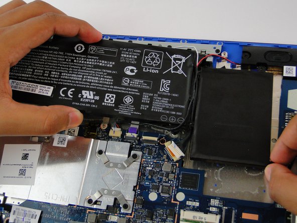

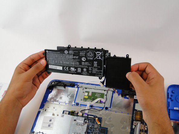

    • Using the JIS J0 screwdriver, unscrew the 6.5 mm screws surrounding the battery.
  5. HP Stream x360 11-p010nr Battery Replacement: crwdns2935265:05crwdnd2935265:01crwdnd2935265:01crwdne2935265:0
    • Carefully remove the surrounding wire away from the battery
  6. HP Stream x360 11-p010nr Battery Replacement: crwdns2935265:06crwdnd2935265:01crwdnd2935265:03crwdne2935265:0 HP Stream x360 11-p010nr Battery Replacement: crwdns2935265:06crwdnd2935265:02crwdnd2935265:03crwdne2935265:0 HP Stream x360 11-p010nr Battery Replacement: crwdns2935265:06crwdnd2935265:03crwdnd2935265:03crwdne2935265:0
    • Lastly, unhook the clip connecting the battery to the motherboard by pushing it away from the slot.
    • At this point, everything should be disconnected, simply remove the battery. Be sure to maneuver around the wire that runs between the middle of the battery.
