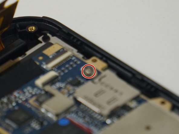

    2. HP Stream 7  Motherboard Replacement: crwdns2935265:05crwdnd2935265:01crwdnd2935265:02crwdne2935265:0 HP Stream 7  Motherboard Replacement: crwdns2935265:05crwdnd2935265:02crwdnd2935265:02crwdne2935265:0
      • Remove the two 2 mm Phillips 000 screws from the motherboard.

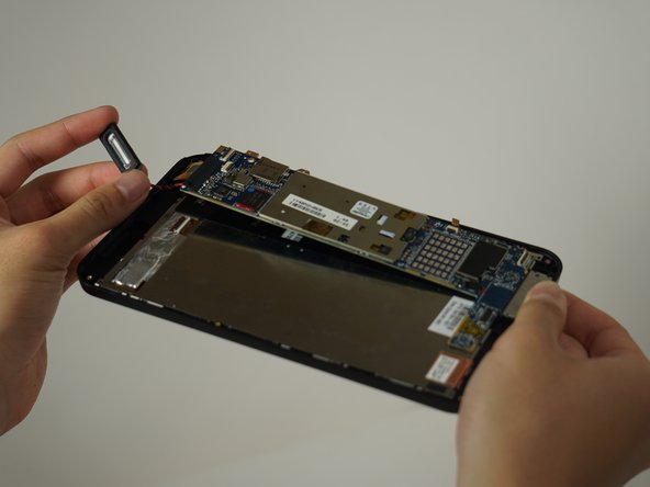

    3. HP Stream 7  Motherboard Replacement: crwdns2935265:06crwdnd2935265:01crwdnd2935265:02crwdne2935265:0 HP Stream 7  Motherboard Replacement: crwdns2935265:06crwdnd2935265:02crwdnd2935265:02crwdne2935265:0
      • Once unscrewed, the motherboard separates from the rest of the device.
      • The speaker is soldered to the motherboard, but it comes off easily.
      • Forced separation may result in a damaged motherboard and/or personal injury.
