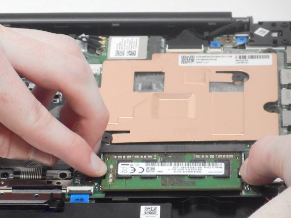

  4. HP Stream 14-CB174WM RAM Replacement, RAM: crwdns2935265:04crwdnd2935265:01crwdnd2935265:02crwdne2935265:0 HP Stream 14-CB174WM RAM Replacement, RAM: crwdns2935265:04crwdnd2935265:02crwdnd2935265:02crwdne2935265:0
    • There are spring-loaded metal clips on each side of the RAM stick. Place your fingers on each metal clip and push them to the side.
    • The RAM will lift a few millimeters; this is normal.
