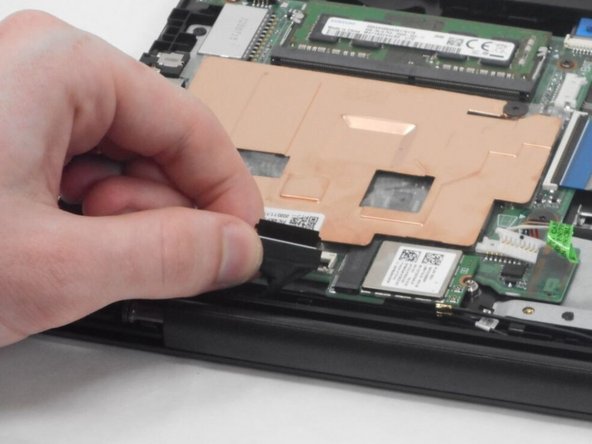

    • Use your fingers or the point of a spudger to slowly “wiggle” the battery connector directly out of its socket.
    • Do not pull on the wires.

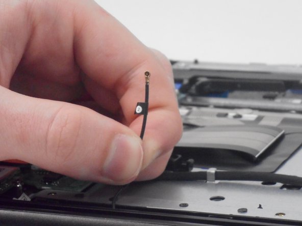

    • Use a plastic opening tool to gently lift and detach the two Wi-Fi card antenna cables.
    • Each wire features numbered tags (1 and 2) corresponding to identical numbers printed on the card. These numbers indicate the designated ports on the wifi card where each wire should be plugged in.

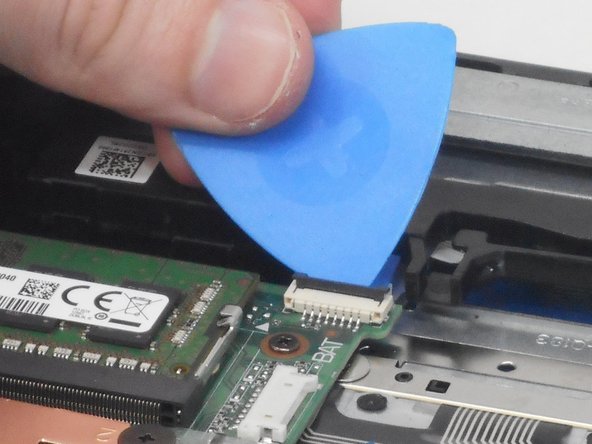

  10. HP Stream 14-CB174WM Motherboard Replacement: crwdns2935265:010crwdnd2935265:01crwdnd2935265:01crwdne2935265:0
    • Remove the single screw that secures the Wi-Fi card using a Phillips screwdriver.

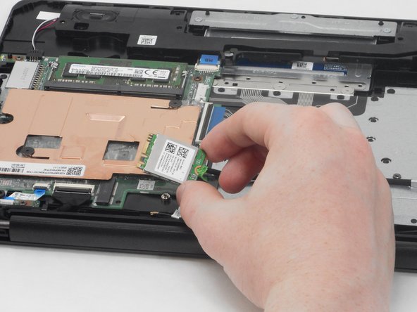

  11. HP Stream 14-CB174WM Motherboard Replacement: crwdns2935265:011crwdnd2935265:01crwdnd2935265:02crwdne2935265:0 HP Stream 14-CB174WM Motherboard Replacement: crwdns2935265:011crwdnd2935265:02crwdnd2935265:02crwdne2935265:0
    • Pull the card directly out of its socket.

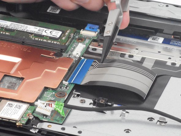

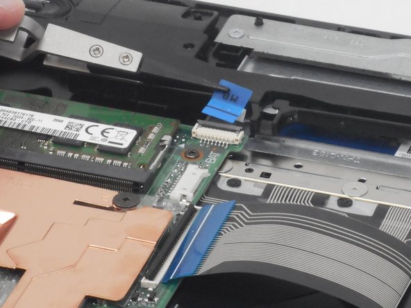

  12. HP Stream 14-CB174WM Motherboard Replacement, Motherboard: crwdns2935265:012crwdnd2935265:01crwdnd2935265:03crwdne2935265:0 HP Stream 14-CB174WM Motherboard Replacement, Motherboard: crwdns2935265:012crwdnd2935265:02crwdnd2935265:03crwdne2935265:0 HP Stream 14-CB174WM Motherboard Replacement, Motherboard: crwdns2935265:012crwdnd2935265:03crwdnd2935265:03crwdne2935265:0
    • Use an opening tool or your fingernail to flip up the black ZIF connector locking flap next to the RAM.
    • Use tweezers to grip and pull the blue plastic tab on the ribbon cable.
    • Remove the ribbon cable.
    • Ribbon cables are delicate and can tear if pulled directly. Instead, grasp and gently pull the blue plastic tab protruding from the connector to release the cable. Avoid using metal tweezers on the cable as they can damage it; opt for tweezers with soft, non-abrasive tips for safer handling.

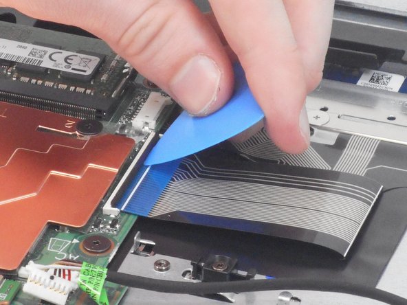

  13. HP Stream 14-CB174WM Motherboard Replacement: crwdns2935265:013crwdnd2935265:01crwdnd2935265:03crwdne2935265:0 HP Stream 14-CB174WM Motherboard Replacement: crwdns2935265:013crwdnd2935265:02crwdnd2935265:03crwdne2935265:0 HP Stream 14-CB174WM Motherboard Replacement: crwdns2935265:013crwdnd2935265:03crwdnd2935265:03crwdne2935265:0
    • Use an opening tool or your fingernail to flip up the black ZIF connector locking flap on the right side of the motherboard.

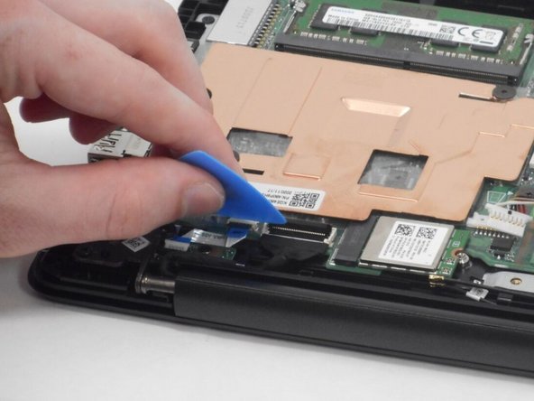

  14. HP Stream 14-CB174WM Motherboard Replacement: crwdns2935265:014crwdnd2935265:01crwdnd2935265:03crwdne2935265:0 HP Stream 14-CB174WM Motherboard Replacement: crwdns2935265:014crwdnd2935265:02crwdnd2935265:03crwdne2935265:0 HP Stream 14-CB174WM Motherboard Replacement: crwdns2935265:014crwdnd2935265:03crwdnd2935265:03crwdne2935265:0
    • Use an opening tool or your fingernail to flip up the black ZIF connector locking flap on the lower-left side of the motherboard.

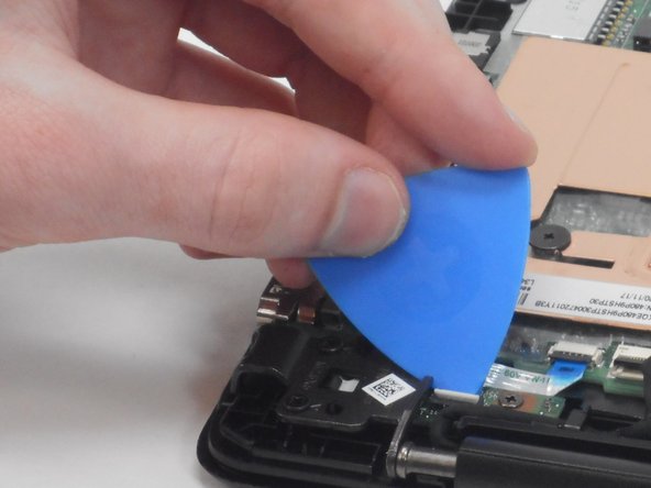

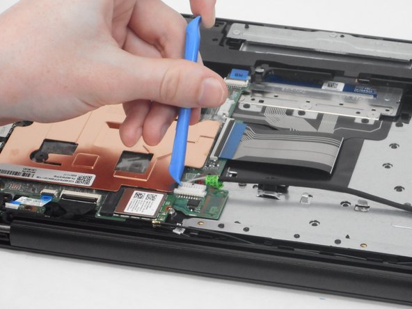

    • Flip up on the black locking flap that secures the display cable.
    • Remove the cable.

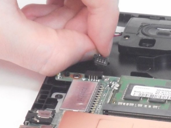

    • Use two plastic opening tools to gently "walk" the the speaker connector directly out of its motherboard port.

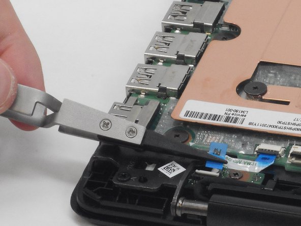

  17. HP Stream 14-CB174WM Motherboard Replacement: crwdns2935265:017crwdnd2935265:01crwdnd2935265:02crwdne2935265:0 HP Stream 14-CB174WM Motherboard Replacement: crwdns2935265:017crwdnd2935265:02crwdnd2935265:02crwdne2935265:0
    • Use two plastic opening tools to "walk" the white sliding connector directly out of its port.
    • This connector is for the laptop's power board.

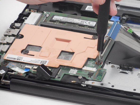

  18. HP Stream 14-CB174WM Motherboard Replacement: crwdns2935265:018crwdnd2935265:01crwdnd2935265:02crwdne2935265:0 HP Stream 14-CB174WM Motherboard Replacement: crwdns2935265:018crwdnd2935265:02crwdnd2935265:02crwdne2935265:0
    • Use a Phillips screwdriver to remove the three wide-head screws from the motherboard.
    • Use a Phillips screwdriver to remove the two small-head screws from the motherboard.
    • Do not unscrew the two screws that secure the heatsink.
    • The heatsink is the large copper plate screwed into the motherboard.
  19. HP Stream 14-CB174WM Motherboard Replacement: crwdns2935265:019crwdnd2935265:01crwdnd2935265:01crwdne2935265:0
    • Lift the motherboard straight up and out of the laptop chassis.
    • The motherboard should come out with no force. If it does not lift up with little force, check for screws you may have missed.
