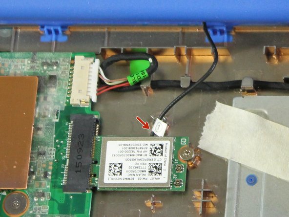

  11. HP Stream 13-c110nr WLAN Module Replacement, WLAN Module: crwdns2935265:011crwdnd2935265:01crwdnd2935265:02crwdne2935265:0 HP Stream 13-c110nr WLAN Module Replacement, WLAN Module: crwdns2935265:011crwdnd2935265:02crwdnd2935265:02crwdne2935265:0
    • Disconnect the WLAN antenna cable from the WLAN module.
  12. HP Stream 13-c110nr WLAN Module Replacement: crwdns2935265:012crwdnd2935265:01crwdnd2935265:01crwdne2935265:0
    • Remove one (1) Phillips P0 PM2.0x3.0 mm screw.
    • Place one (1) screw on magnetic mat for reassembly.
  13. HP Stream 13-c110nr WLAN Module Replacement: crwdns2935265:013crwdnd2935265:01crwdnd2935265:01crwdne2935265:0
    • Remove the WLAN Module from device.
