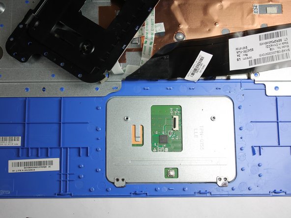

  11. HP Stream 13-c110nr Touchpad Assembly Replacement, Touchpad Assembly: crwdns2935265:011crwdnd2935265:01crwdnd2935265:02crwdne2935265:0 HP Stream 13-c110nr Touchpad Assembly Replacement, Touchpad Assembly: crwdns2935265:011crwdnd2935265:02crwdnd2935265:02crwdne2935265:0
    • Place the Top Cover/Keyboard assembly face down with the front towards you.

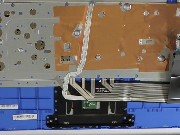

  12. HP Stream 13-c110nr Touchpad Assembly Replacement: crwdns2935265:012crwdnd2935265:01crwdnd2935265:02crwdne2935265:0 HP Stream 13-c110nr Touchpad Assembly Replacement: crwdns2935265:012crwdnd2935265:02crwdnd2935265:02crwdne2935265:0
    • Remove the TouchPad cable.
  13. HP Stream 13-c110nr Touchpad Assembly Replacement: crwdns2935265:013crwdnd2935265:01crwdnd2935265:01crwdne2935265:0
    • Remove two (2) Phillips P0 PM2.5x3.0 mm screws from Touchpad assembly.
    • Place two (2) screws on magnetic mat for reassembly.

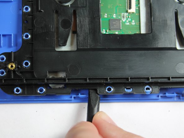

  14. HP Stream 13-c110nr Touchpad Assembly Replacement: crwdns2935265:014crwdnd2935265:01crwdnd2935265:03crwdne2935265:0 HP Stream 13-c110nr Touchpad Assembly Replacement: crwdns2935265:014crwdnd2935265:02crwdnd2935265:03crwdne2935265:0 HP Stream 13-c110nr Touchpad Assembly Replacement: crwdns2935265:014crwdnd2935265:03crwdnd2935265:03crwdne2935265:0
    • Use the plastic pick to pry up the black TouchPad cover from the blue top cover.
    • The TouchPad cover is molded to the Top Cover/Keyboard. Slight pressure must be maintained to release the cover.
    • A popping noise may be heard when prying the touchpad cover off of the top cover.

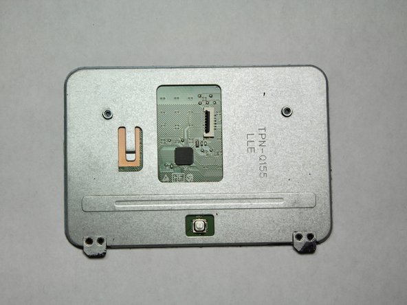

  15. HP Stream 13-c110nr Touchpad Assembly Replacement: crwdns2935265:015crwdnd2935265:01crwdnd2935265:02crwdne2935265:0 HP Stream 13-c110nr Touchpad Assembly Replacement: crwdns2935265:015crwdnd2935265:02crwdnd2935265:02crwdne2935265:0
    • Remove the Touchpad assembly from the device.
