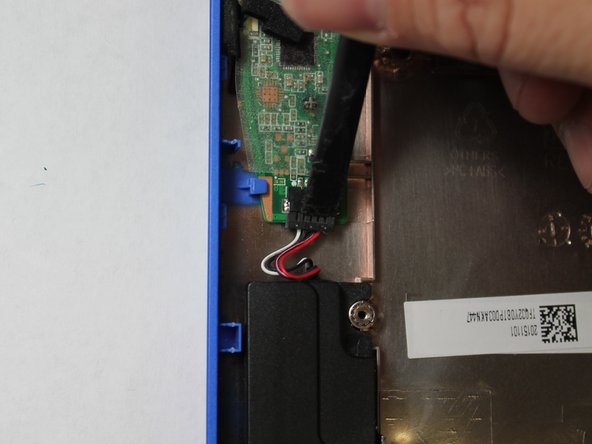

    • Use a pick to disconnect the Speaker Cable from the System Board.

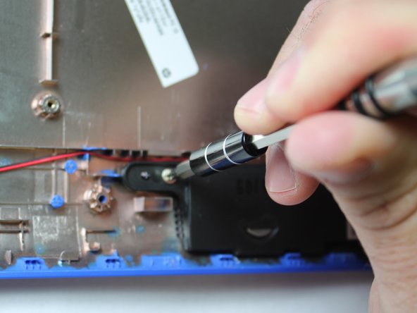

    • Remove two (2) P0 PM 2.0 x 3.0 mm screws from speaker assembly.
    • Place two (2) screws on magnetic mat for reassembly.
  16. HP Stream 13-c110nr Speakers Replacement: crwdns2935265:016crwdnd2935265:01crwdnd2935265:01crwdne2935265:0
    • Remove the Speakers from the device.
