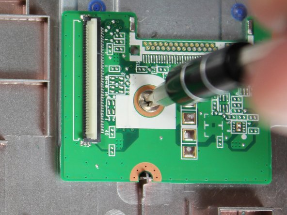

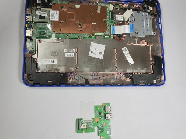

  17. HP Stream 13-c110nr Motherboard Replacement, USB/Card Reader Board: crwdns2935265:017crwdnd2935265:01crwdnd2935265:02crwdne2935265:0 HP Stream 13-c110nr Motherboard Replacement, USB/Card Reader Board: crwdns2935265:017crwdnd2935265:02crwdnd2935265:02crwdne2935265:0
    • Use a pick to disconnect the USB/Card Reader cable from the System Board.
  18. HP Stream 13-c110nr Motherboard Replacement: crwdns2935265:018crwdnd2935265:01crwdnd2935265:02crwdne2935265:0 HP Stream 13-c110nr Motherboard Replacement: crwdns2935265:018crwdnd2935265:02crwdnd2935265:02crwdne2935265:0
    • Remove three (3) Phillips P0 PM2.0x3.0 mm screws.
    • Place three (3) screws on magnetic mat for reassembly.
  19. HP Stream 13-c110nr Motherboard Replacement: crwdns2935265:019crwdnd2935265:01crwdnd2935265:02crwdne2935265:0 HP Stream 13-c110nr Motherboard Replacement: crwdns2935265:019crwdnd2935265:02crwdnd2935265:02crwdne2935265:0
    • Remove the USB/Card Reader board assembly from the device.

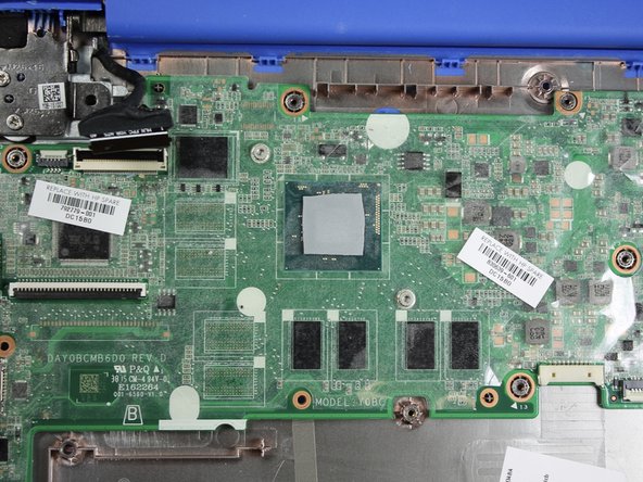

  22. HP Stream 13-c110nr Motherboard Replacement, Motherboard: crwdns2935265:022crwdnd2935265:01crwdnd2935265:01crwdne2935265:0
    • Disconnect the Display Cable.

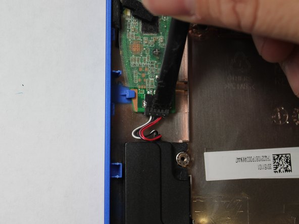

  23. HP Stream 13-c110nr Motherboard Replacement: crwdns2935265:023crwdnd2935265:01crwdnd2935265:02crwdne2935265:0 HP Stream 13-c110nr Motherboard Replacement: crwdns2935265:023crwdnd2935265:02crwdnd2935265:02crwdne2935265:0
    • Disconnect the Speaker Cable.

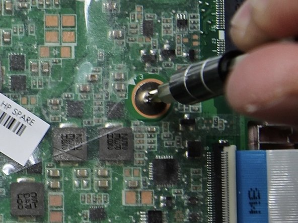

  24. HP Stream 13-c110nr Motherboard Replacement: crwdns2935265:024crwdnd2935265:01crwdnd2935265:03crwdne2935265:0 HP Stream 13-c110nr Motherboard Replacement: crwdns2935265:024crwdnd2935265:02crwdnd2935265:03crwdne2935265:0 HP Stream 13-c110nr Motherboard Replacement: crwdns2935265:024crwdnd2935265:03crwdnd2935265:03crwdne2935265:0
    • Remove five (5) Phillips P0 PM2.5x3.0 mm screws from System Board assembly.
    • Place five (5) screws on magnetic mat for reassembly.
  25. HP Stream 13-c110nr Motherboard Replacement: crwdns2935265:025crwdnd2935265:01crwdnd2935265:02crwdne2935265:0 HP Stream 13-c110nr Motherboard Replacement: crwdns2935265:025crwdnd2935265:02crwdnd2935265:02crwdne2935265:0
    • Lift the right side of the System Board and slide it from the device.
