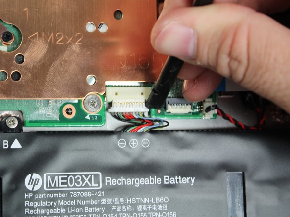

  11. HP Stream 13-c110nr Heat Sink Replacement, Battery Assembly: crwdns2935265:011crwdnd2935265:01crwdnd2935265:02crwdne2935265:0 HP Stream 13-c110nr Heat Sink Replacement, Battery Assembly: crwdns2935265:011crwdnd2935265:02crwdnd2935265:02crwdne2935265:0
    • Use a pick to detach the Battery assembly cable.
  12. HP Stream 13-c110nr Heat Sink Replacement: crwdns2935265:012crwdnd2935265:01crwdnd2935265:02crwdne2935265:0 HP Stream 13-c110nr Heat Sink Replacement: crwdns2935265:012crwdnd2935265:02crwdnd2935265:02crwdne2935265:0
    • Remove eight (8) Phillips P0 PM2.0x3.0 mm screws from Battery assembly.
    • Place eight (8) screws on magnetic mat for reassembly.
  13. HP Stream 13-c110nr Heat Sink Replacement: crwdns2935265:013crwdnd2935265:01crwdnd2935265:01crwdne2935265:0
    • Remove Battery Assembly from device.

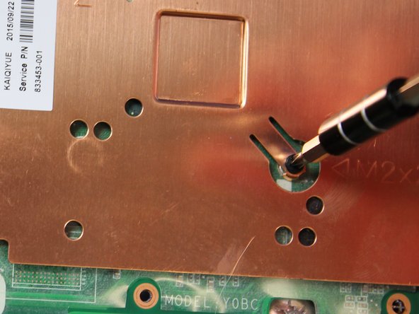

  14. HP Stream 13-c110nr Heat Sink Replacement, Heat Sink: crwdns2935265:014crwdnd2935265:01crwdnd2935265:02crwdne2935265:0 HP Stream 13-c110nr Heat Sink Replacement, Heat Sink: crwdns2935265:014crwdnd2935265:02crwdnd2935265:02crwdne2935265:0
    • Remove two (2) Phillips P0 PM2.0x2.0 mm screws.
    • Place two (2) screws on magnetic mat for reassembly.
  15. HP Stream 13-c110nr Heat Sink Replacement: crwdns2935265:015crwdnd2935265:01crwdnd2935265:01crwdne2935265:0
    • Remove the Heat Sink from the System Board.
