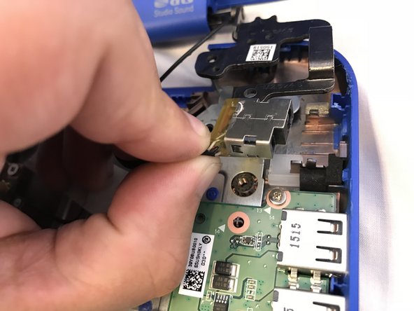

  5. HP Stream 13-c010nr Charging Port Replacement, Charging Port: crwdns2935265:05crwdnd2935265:01crwdnd2935265:01crwdne2935265:0
    • Disconnect the charging port from the motherboard.
  6. HP Stream 13-c010nr Charging Port Replacement: crwdns2935265:06crwdnd2935265:01crwdnd2935265:02crwdne2935265:0 HP Stream 13-c010nr Charging Port Replacement: crwdns2935265:06crwdnd2935265:02crwdnd2935265:02crwdne2935265:0
    • Remove the two 5mm Phillips screws from the charging port.
    • Remove the bracket.
    • Pull out the charging port.
