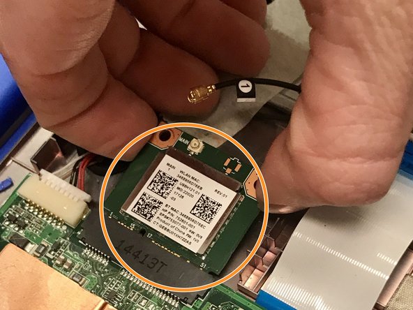

  3. HP Stream 13-c002dx Wireless Card  Replacement, Wireless Card: crwdns2935265:03crwdnd2935265:01crwdnd2935265:03crwdne2935265:0 HP Stream 13-c002dx Wireless Card  Replacement, Wireless Card: crwdns2935265:03crwdnd2935265:02crwdnd2935265:03crwdne2935265:0 HP Stream 13-c002dx Wireless Card  Replacement, Wireless Card: crwdns2935265:03crwdnd2935265:03crwdnd2935265:03crwdne2935265:0
    • Inside the laptop you will notice the wireless card located in the upper middle. This will be what you are replacing.
    • Attached to the Wi-Fi card is a black wire that must be removed. Using your hand, lift gently on the wire as close as you can to where it connects to the Wi-Fi card.
    • Once the wire is removed, set it aside so it does not get damaged.
  4. HP Stream 13-c002dx Wireless Card  Replacement: crwdns2935265:04crwdnd2935265:01crwdnd2935265:03crwdne2935265:0 HP Stream 13-c002dx Wireless Card  Replacement: crwdns2935265:04crwdnd2935265:02crwdnd2935265:03crwdne2935265:0 HP Stream 13-c002dx Wireless Card  Replacement: crwdns2935265:04crwdnd2935265:03crwdnd2935265:03crwdne2935265:0
    • Remove the screw holding the wireless card in place.
    • With the screw removed, gently pull back the Wi-Fi card and then lift it out of the laptop. You are now ready to insert the new wireless card.
