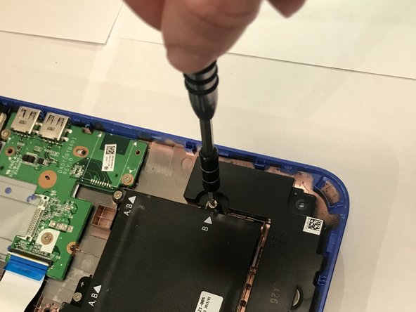

  3. HP Stream 13-c002dx Speakers Replacement, Speakers: crwdns2935265:03crwdnd2935265:01crwdnd2935265:03crwdne2935265:0 HP Stream 13-c002dx Speakers Replacement, Speakers: crwdns2935265:03crwdnd2935265:02crwdnd2935265:03crwdne2935265:0 HP Stream 13-c002dx Speakers Replacement, Speakers: crwdns2935265:03crwdnd2935265:03crwdnd2935265:03crwdne2935265:0
    • You will notice various screws located on the outer edges of the speakers. Using your Philips screwdriver, remove each of these screws.

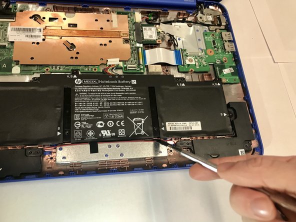

    • Connecting the two speakers is a red and black wire located at the edge of the battery. Using your flathead screwdriver, lift the wire upward.

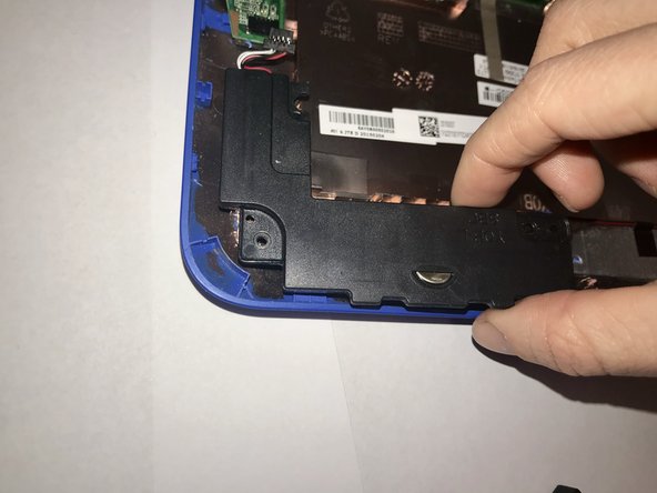

    • Carefully remove the right and left components of the battery out of the device.
    • You have successfully removed the speakers from the device.
