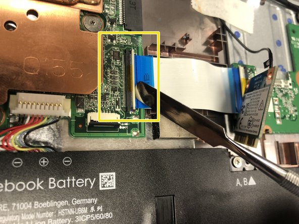

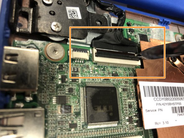

  7. HP Stream 13-c002dx Motherboard Replacement, Motherboard: crwdns2935265:07crwdnd2935265:01crwdnd2935265:03crwdne2935265:0 HP Stream 13-c002dx Motherboard Replacement, Motherboard: crwdns2935265:07crwdnd2935265:02crwdnd2935265:03crwdne2935265:0 HP Stream 13-c002dx Motherboard Replacement, Motherboard: crwdns2935265:07crwdnd2935265:03crwdnd2935265:03crwdne2935265:0
    • Once you have access to the internals, remove the wires and wifi card connected to the motherboard.
    • To remove the upper wire connection, flip the tab holding the cable onto the motherboard, then remove it gently.
    • To remove the wire strand connection, flip the tab shown and then remove the wire strand.
    • Do you not use a metal spudger as shown in the photo. A nylon spudger is the appropriate tool for the job and will not damage the motherboard as a metal spudger might do.

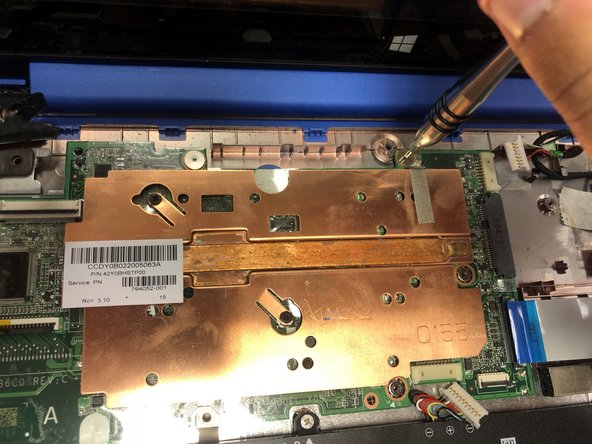

  8. HP Stream 13-c002dx Motherboard Replacement: crwdns2935265:08crwdnd2935265:01crwdnd2935265:02crwdne2935265:0 HP Stream 13-c002dx Motherboard Replacement: crwdns2935265:08crwdnd2935265:02crwdnd2935265:02crwdne2935265:0
    • Using a Phillips #0 screwdriver, remove the six screws holding the motherboard down.

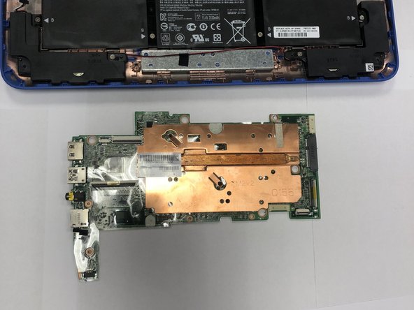

  9. HP Stream 13-c002dx Motherboard Replacement: crwdns2935265:09crwdnd2935265:01crwdnd2935265:02crwdne2935265:0 HP Stream 13-c002dx Motherboard Replacement: crwdns2935265:09crwdnd2935265:02crwdnd2935265:02crwdne2935265:0
    • Now, gently pry up on the right side of the motherboard with the spudger and then lift the motherboard out.
