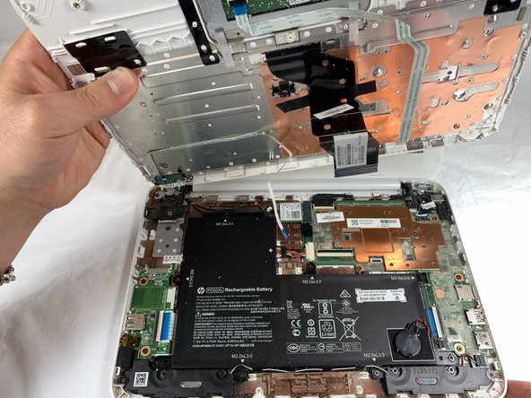

    • Turn the laptop upright and lift the screen.
    • Use the metal spudger to carefully pry the plastic keyboard from the base of the laptop.
    • Work the spudger carefully and slowly around the cover to release the clips holding it together. Be patient since there are a lot of clips attaching the laptop base to the keyboard.
    • Gently lift up the keyboard.

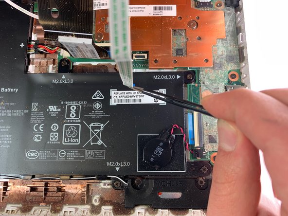

  4. HP Stream 11-y012nr Battery  Replacement: crwdns2935265:04crwdnd2935265:01crwdnd2935265:03crwdne2935265:0 HP Stream 11-y012nr Battery  Replacement: crwdns2935265:04crwdnd2935265:02crwdnd2935265:03crwdne2935265:0 HP Stream 11-y012nr Battery  Replacement: crwdns2935265:04crwdnd2935265:03crwdnd2935265:03crwdne2935265:0
    • The keyboard is attached by three cables. Be careful not to lift the cover too far so you do not damage these cables.
    • Using tweezers, unplug the three cables attached to the keyboard. To do so you will find where the wires end (the three red marks). Use tweezers or your fingers to pinch the plastic piece holding the wires, and gently pull the piece out. After that it should disconnect.
    • Lift up the plastic keyboard cover.

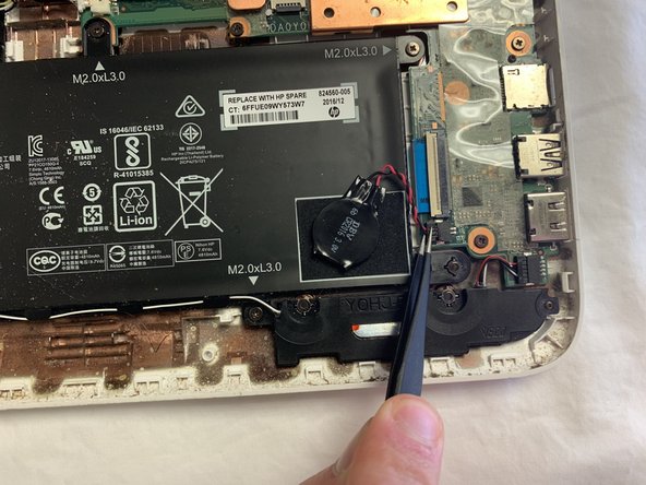

  5. HP Stream 11-y012nr Battery  Replacement: crwdns2935265:05crwdnd2935265:01crwdnd2935265:02crwdne2935265:0 HP Stream 11-y012nr Battery  Replacement: crwdns2935265:05crwdnd2935265:02crwdnd2935265:02crwdne2935265:0
    • Using tweezers or a plastic spudger, disconnect the two bundled cable connectors connecting the battery to the motherboard.

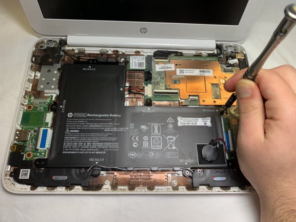

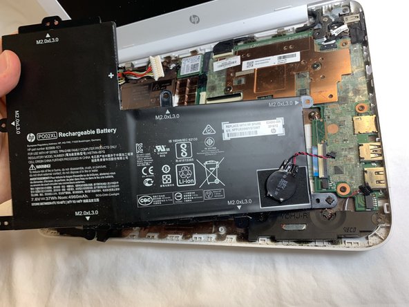

  6. HP Stream 11-y012nr Battery  Replacement: crwdns2935265:06crwdnd2935265:01crwdnd2935265:03crwdne2935265:0 HP Stream 11-y012nr Battery  Replacement: crwdns2935265:06crwdnd2935265:02crwdnd2935265:03crwdne2935265:0 HP Stream 11-y012nr Battery  Replacement: crwdns2935265:06crwdnd2935265:03crwdnd2935265:03crwdne2935265:0
    • Unscrew the seven 3.3mm Phillips #000 screws.
    • Gently lift the battery out.
