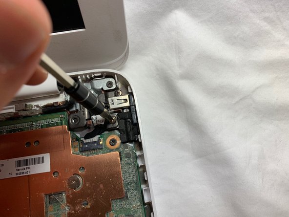

  5. HP Stream 11-y012nr Audio Jack Replacement: crwdns2935265:05crwdnd2935265:01crwdnd2935265:02crwdne2935265:0 HP Stream 11-y012nr Audio Jack Replacement: crwdns2935265:05crwdnd2935265:02crwdnd2935265:02crwdne2935265:0
    • Remove the two 5.6 mm Phillips #00 screws.

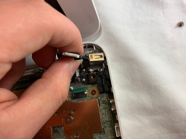

  6. HP Stream 11-y012nr Audio Jack Replacement: crwdns2935265:06crwdnd2935265:01crwdnd2935265:02crwdne2935265:0 HP Stream 11-y012nr Audio Jack Replacement: crwdns2935265:06crwdnd2935265:02crwdnd2935265:02crwdne2935265:0
    • Using tweezers or a nylon spudger, gently unplug the cable connector.
  7. HP Stream 11-y012nr Audio Jack Replacement: crwdns2935265:07crwdnd2935265:01crwdnd2935265:01crwdne2935265:0
    • Remove the audio jack.
