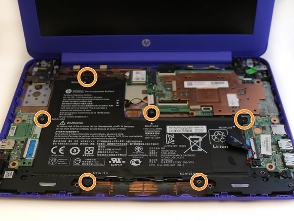

  10. HP Stream 11-r020nr Battery Replacement: crwdns2935265:010crwdnd2935265:01crwdnd2935265:02crwdne2935265:0 HP Stream 11-r020nr Battery Replacement: crwdns2935265:010crwdnd2935265:02crwdnd2935265:02crwdne2935265:0
    • Gently pull the wire away from the battery.
    • Using the Phillips #1 screwdriver, remove the six 3mm screws.
  11. HP Stream 11-r020nr Battery Replacement: crwdns2935265:011crwdnd2935265:01crwdnd2935265:01crwdne2935265:0
    • Gently lift and pull the battery out of the device.
