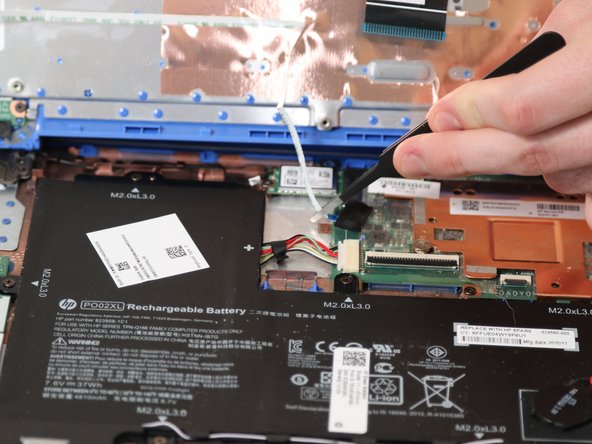

    • Identify two ribbon connectors and the ZIF cable underneath the keyboard.
    • Use tweezers to disconnect both ribbon cables and the ZIF connector.

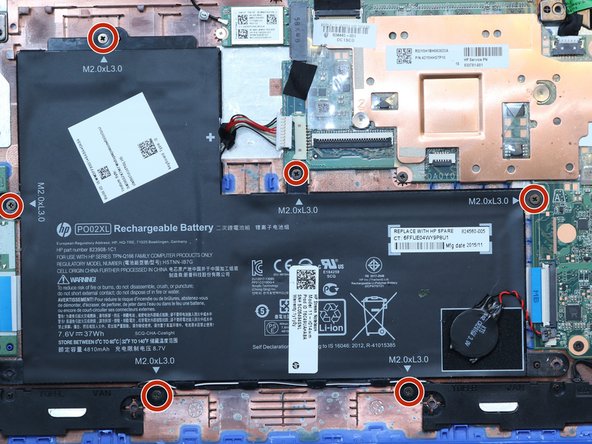

    • Use a Phillips #00 screwdriver to remove six 5 millimeter screws from the battery.

    • Use a plastic spudger to remove the two power connectors.
    • Lift the battery out.
