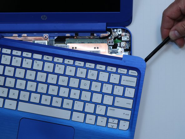

    • Turn the computer over and open it.
    • Use a plastic spudger to pry the keyboard bezel away from the base. Pry around the edge, being careful not to jam the spudger too far underneath the bezel (potentially damaging internal components).
    • The bezel is tightest near the hinge.
    • Once the bezel is free, do not lift it away from the base.

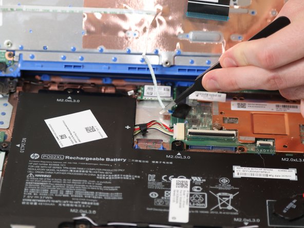

    • Identify two ribbon connectors and the ZIF cable underneath the keyboard.
    • Use tweezers to disconnect both ribbon cables and the ZIF connector.

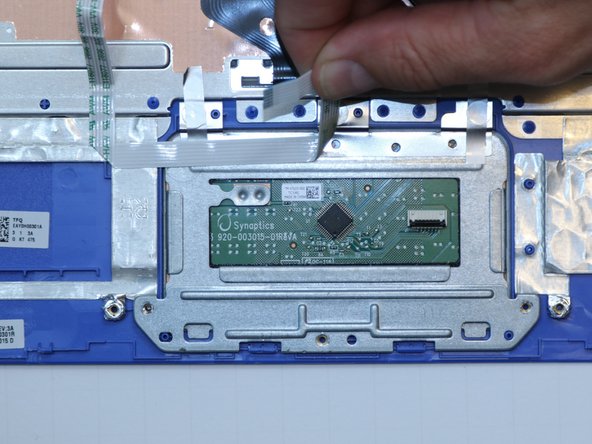

    • Flip the keyboard over to locate the trackpad.
  6. HP Stream 11-r014wm  Trackpad Replacement: crwdns2935265:06crwdnd2935265:01crwdnd2935265:03crwdne2935265:0 HP Stream 11-r014wm  Trackpad Replacement: crwdns2935265:06crwdnd2935265:02crwdnd2935265:03crwdne2935265:0 HP Stream 11-r014wm  Trackpad Replacement: crwdns2935265:06crwdnd2935265:03crwdnd2935265:03crwdne2935265:0

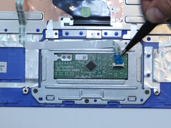

    • Use a plastic spudger to remove the black, plastic tab holding down the ZIF connector.
    • The black, plastic tab may pop away uncontrollably.
    • Use tweezers to lift out the ZIF connector.
    • Peel the ZIF cable away from the trackpad.
  7. HP Stream 11-r014wm  Trackpad Replacement: crwdns2935265:07crwdnd2935265:01crwdnd2935265:03crwdne2935265:0 HP Stream 11-r014wm  Trackpad Replacement: crwdns2935265:07crwdnd2935265:02crwdnd2935265:03crwdne2935265:0 HP Stream 11-r014wm  Trackpad Replacement: crwdns2935265:07crwdnd2935265:03crwdnd2935265:03crwdne2935265:0
    • Use a Phillips #00 screwdriver to unscrew three 2.25 millimeter screws from the trackpad.
    • Peel back the tape covering two screws.
    • Use a Phillips #00 screwdriver to unscrew three 1.5 millimeter screws from the trackpad.
  8. HP Stream 11-r014wm  Trackpad Replacement: crwdns2935265:08crwdnd2935265:01crwdnd2935265:01crwdne2935265:0
    • Use a plastic spudger to lift the trackpad away from the keyboard.
