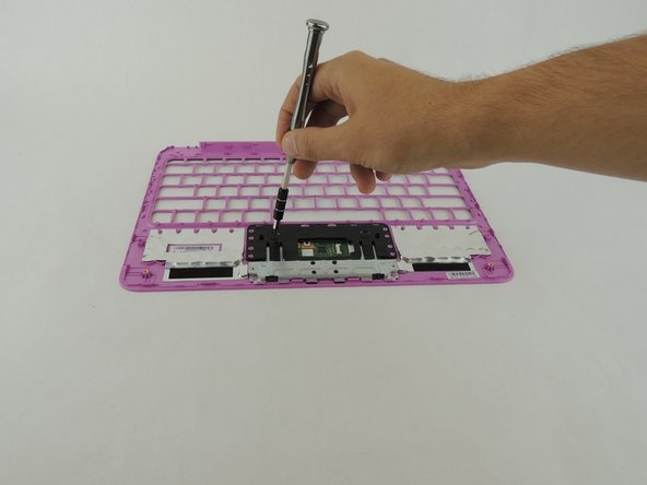

    1. HP Stream 11-d020nr Trackpad Replacement, Trackpad: crwdns2935265:05crwdnd2935265:01crwdnd2935265:02crwdne2935265:0 HP Stream 11-d020nr Trackpad Replacement, Trackpad: crwdns2935265:05crwdnd2935265:02crwdnd2935265:02crwdne2935265:0
      • On the back of the plastic keyboard cover, remove the two 2 mm Phillips #000 screws.
    2. HP Stream 11-d020nr Trackpad Replacement: crwdns2935265:06crwdnd2935265:01crwdnd2935265:01crwdne2935265:0
      • Lift up the plastic cover to release the ClickPad.
