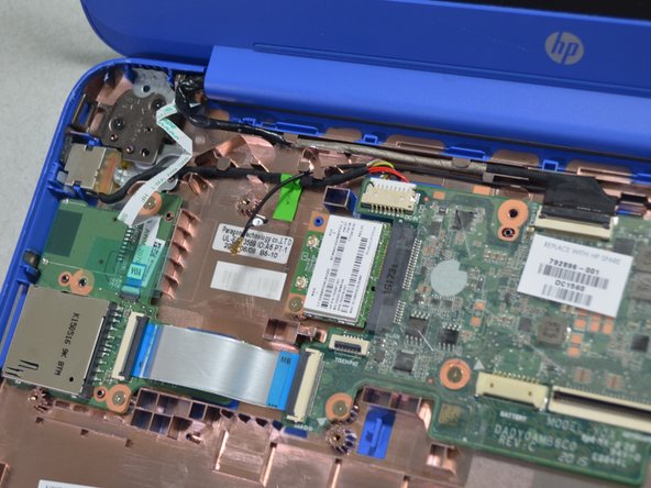

  9. HP Stream 11-d010nr Wifi Chip Replacement, Wifi Chip: crwdns2935265:09crwdnd2935265:01crwdnd2935265:02crwdne2935265:0 HP Stream 11-d010nr Wifi Chip Replacement, Wifi Chip: crwdns2935265:09crwdnd2935265:02crwdnd2935265:02crwdne2935265:0
    • Unplug the black wire attached to the wireless chip.
  10. HP Stream 11-d010nr Wifi Chip Replacement: crwdns2935265:010crwdnd2935265:01crwdnd2935265:02crwdne2935265:0 HP Stream 11-d010nr Wifi Chip Replacement: crwdns2935265:010crwdnd2935265:02crwdnd2935265:02crwdne2935265:0

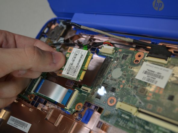

    • Remove the one 3mm Phillips #000 screw holding the wireless chip in place.
    • Lift the wireless chip up and out.
