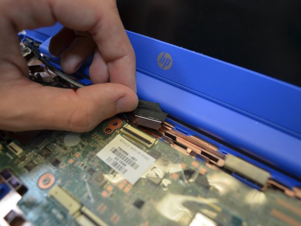

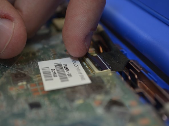

    1. HP Stream 11-d010nr Webcam Replacement, Webcam: crwdns2935265:011crwdnd2935265:01crwdnd2935265:03crwdne2935265:0 HP Stream 11-d010nr Webcam Replacement, Webcam: crwdns2935265:011crwdnd2935265:02crwdnd2935265:03crwdne2935265:0 HP Stream 11-d010nr Webcam Replacement, Webcam: crwdns2935265:011crwdnd2935265:03crwdnd2935265:03crwdne2935265:0
      • Flip up the flap and unplug the display cord from the motherboard.

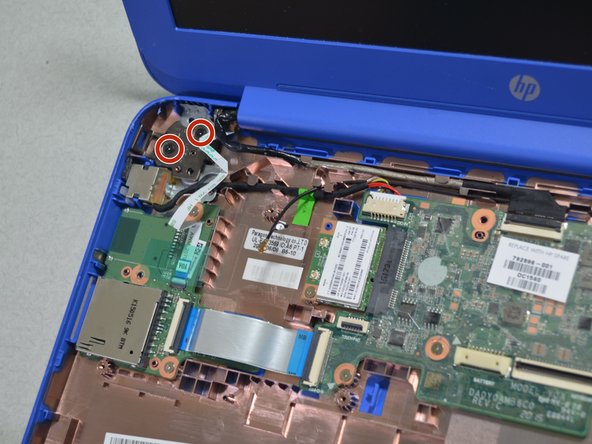

    2. HP Stream 11-d010nr Webcam Replacement: crwdns2935265:012crwdnd2935265:01crwdnd2935265:02crwdne2935265:0 HP Stream 11-d010nr Webcam Replacement: crwdns2935265:012crwdnd2935265:02crwdnd2935265:02crwdne2935265:0
      • Using a JIS #1 screwdriver, remove the four 2.2 mm screws holding monitor to body.

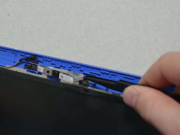

      • Open the upper lid with the iFixit opening tool.
    5. HP Stream 11-d010nr Webcam Replacement: crwdns2935265:015crwdnd2935265:01crwdnd2935265:02crwdne2935265:0 HP Stream 11-d010nr Webcam Replacement: crwdns2935265:015crwdnd2935265:02crwdnd2935265:02crwdne2935265:0
      • Disconnect the webcam cord using tweezers.
      • Remove the webcam using tweezers.
