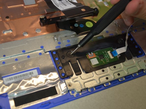

    1. HP Stream 11-d010nr Clickpad Replacement, Clickpad: crwdns2935265:07crwdnd2935265:01crwdnd2935265:02crwdne2935265:0 HP Stream 11-d010nr Clickpad Replacement, Clickpad: crwdns2935265:07crwdnd2935265:02crwdnd2935265:02crwdne2935265:0
      • Remove the two 2mm #000 Phillips screws.
    2. HP Stream 11-d010nr Clickpad Replacement: crwdns2935265:08crwdnd2935265:01crwdnd2935265:01crwdne2935265:0
      • Release the clickpad by lifting the keyboard up.
      • When installing the new clickpad, make sure the black tabs go into the laptop.
