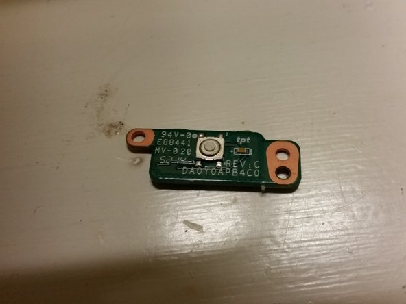

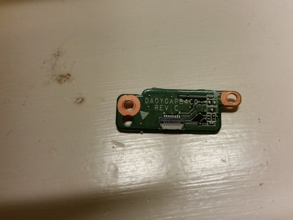

    • Remove the power button connector from the power button by flipping the white tab up and pulling the ribbon cable out
  6. HP Stream 11-d008TU Power Button Replacement, Unscrew Button: crwdns2935265:06crwdnd2935265:01crwdnd2935265:03crwdne2935265:0 HP Stream 11-d008TU Power Button Replacement, Unscrew Button: crwdns2935265:06crwdnd2935265:02crwdnd2935265:03crwdne2935265:0 HP Stream 11-d008TU Power Button Replacement, Unscrew Button: crwdns2935265:06crwdnd2935265:03crwdnd2935265:03crwdne2935265:0
    • Unscrew the two Philips PH0 2.5mm screws
  7. HP Stream 11-d008TU Power Button Replacement: crwdns2935265:07crwdnd2935265:01crwdnd2935265:03crwdne2935265:0 HP Stream 11-d008TU Power Button Replacement: crwdns2935265:07crwdnd2935265:02crwdnd2935265:03crwdne2935265:0 HP Stream 11-d008TU Power Button Replacement: crwdns2935265:07crwdnd2935265:03crwdnd2935265:03crwdne2935265:0
    • Lift the power button out of the slot
