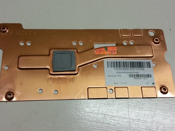

  5. HP Stream 11-d008TU Heatsink Replacement, Unscrew the heatsink: crwdns2935265:05crwdnd2935265:01crwdnd2935265:01crwdne2935265:0
    • Unscrew the four 2.5mm M2x2.5 PH-0 Phillips head screws in reverse numerical order (4-3-2-1)
    • 4: Bottom left | 3: Top Right | 2: Bottom Right | 1: Top Left
  6. HP Stream 11-d008TU Heatsink Replacement, Remove the heatsink: crwdns2935265:06crwdnd2935265:01crwdnd2935265:02crwdne2935265:0 HP Stream 11-d008TU Heatsink Replacement, Remove the heatsink: crwdns2935265:06crwdnd2935265:02crwdnd2935265:02crwdne2935265:0
    • Lift the heatsink
