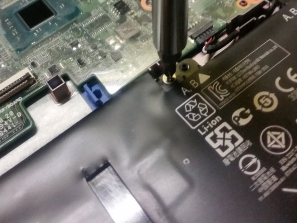

  6. HP Stream 11-d008TU Battery Replacement, Unscrew Battery: crwdns2935265:06crwdnd2935265:01crwdnd2935265:02crwdne2935265:0 HP Stream 11-d008TU Battery Replacement, Unscrew Battery: crwdns2935265:06crwdnd2935265:02crwdnd2935265:02crwdne2935265:0
    • Remove 4x PH-0 Philips head 3mm screws (circled)
  7. HP Stream 11-d008TU Battery Replacement: crwdns2935265:07crwdnd2935265:01crwdnd2935265:03crwdne2935265:0 HP Stream 11-d008TU Battery Replacement: crwdns2935265:07crwdnd2935265:02crwdnd2935265:03crwdne2935265:0 HP Stream 11-d008TU Battery Replacement: crwdns2935265:07crwdnd2935265:03crwdnd2935265:03crwdne2935265:0
    • Lift the battery out of the case vertically
