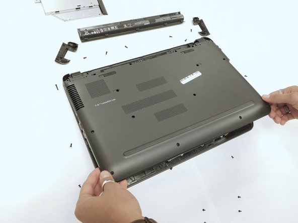

    • Make sure the laptop is fully shut down
    • Remove battery by pushing slide tabs to the left.
    • Remove residual power by holding the power button down for 5 seconds.
  2. HP Star Wars Special Edition 15-an051dx RAM Replacement: crwdns2935265:02crwdnd2935265:01crwdnd2935265:03crwdne2935265:0 HP Star Wars Special Edition 15-an051dx RAM Replacement: crwdns2935265:02crwdnd2935265:02crwdnd2935265:03crwdne2935265:0 HP Star Wars Special Edition 15-an051dx RAM Replacement: crwdns2935265:02crwdnd2935265:03crwdnd2935265:03crwdne2935265:0
    • Set aside any screws removed separately as to not mix them up
    • Use a Phillips #1 screwdriver to remove the two 12.5 mm screws, four 5.5 mm screws, and six 7.25 mm screws.
    • Remove the two corner panels along the ends of the battery slot and this will expose another set of screws (1 under each panel).
    • Remove the remaining six 7.2 mm Phillips #1 screws hidden in the battery area and underneath the covers.

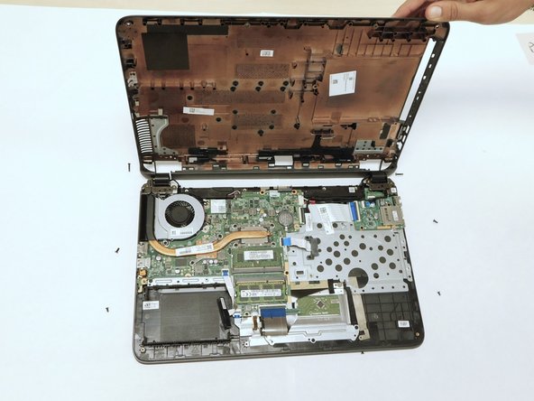

  3. HP Star Wars Special Edition 15-an051dx RAM Replacement: crwdns2935265:03crwdnd2935265:01crwdnd2935265:03crwdne2935265:0 HP Star Wars Special Edition 15-an051dx RAM Replacement: crwdns2935265:03crwdnd2935265:02crwdnd2935265:03crwdne2935265:0 HP Star Wars Special Edition 15-an051dx RAM Replacement: crwdns2935265:03crwdnd2935265:03crwdnd2935265:03crwdne2935265:0
    • Remove the optical drive by pulling on the plastic cover panel.
    • With a prying tool, gently pry the back panel off.
    • Start with the corners of the device and carefully slide the tool towards the middle, lifting the panel off as you go.
    • Set the optical drive and back panel somewhere safe.

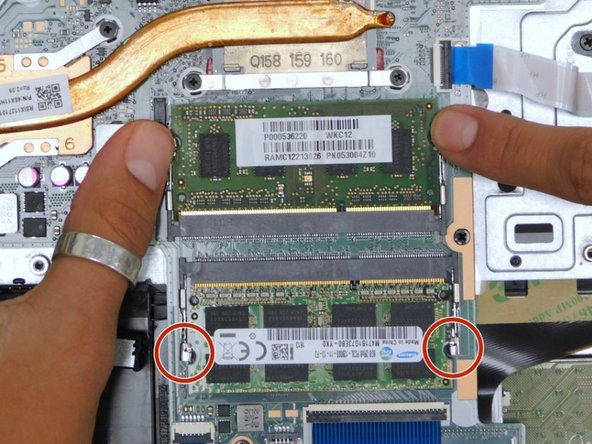

  4. HP Star Wars Special Edition 15-an051dx RAM Replacement: crwdns2935265:04crwdnd2935265:01crwdnd2935265:03crwdne2935265:0 HP Star Wars Special Edition 15-an051dx RAM Replacement: crwdns2935265:04crwdnd2935265:02crwdnd2935265:03crwdne2935265:0 HP Star Wars Special Edition 15-an051dx RAM Replacement: crwdns2935265:04crwdnd2935265:03crwdnd2935265:03crwdne2935265:0
    • You will need to spread the two silver clips that hold the RAM down on its slot.
    • Once both clips are spread apart, this will release the RAM and it will slightly spring upward in an angle.
    • Pull the RAM away in the same orientation.

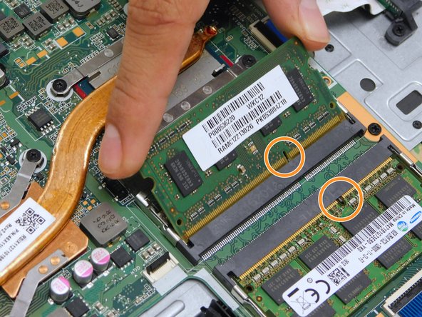

    • Keep in mind the notch on the RAM that connects on to the DIMM slot.

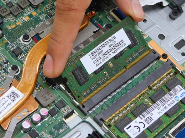

  5. HP Star Wars Special Edition 15-an051dx RAM Replacement: crwdns2935265:05crwdnd2935265:01crwdnd2935265:03crwdne2935265:0 HP Star Wars Special Edition 15-an051dx RAM Replacement: crwdns2935265:05crwdnd2935265:02crwdnd2935265:03crwdne2935265:0 HP Star Wars Special Edition 15-an051dx RAM Replacement: crwdns2935265:05crwdnd2935265:03crwdnd2935265:03crwdne2935265:0
    • Match the notch on new/replacement RAM and gently install it in the same angled orientation.
    • Once the new RAM is installed, gently press and lay the RAM down on its side until it reaches the clips on the side notches and locks in.
    • Do the same for the other DIMM/RAM if replacing or adding another RAM.
