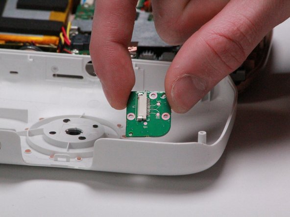

    • Remove two 2.5mm JIS #00 located on the small circuit board in view.
    • Use the Jimmy to remove the board after the screws have been removed.
    • Be careful not to crease or damage the ribbon cable.

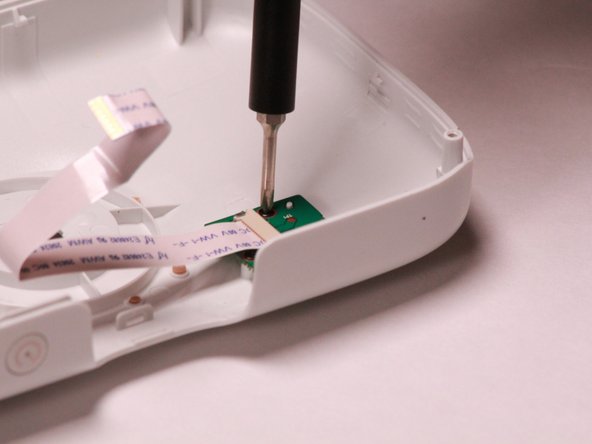

    • Using a Japanese Industrial Standard (J) screwdriver (J00 bit), remove three 2.5mm screws connecting the flash circuit board to the housing.
  9. HP Sprocket 2-in-1 Flash Replacement: crwdns2935265:09crwdnd2935265:01crwdnd2935265:02crwdne2935265:0 HP Sprocket 2-in-1 Flash Replacement: crwdns2935265:09crwdnd2935265:02crwdnd2935265:02crwdne2935265:0
    • Carefully remove ribbon from the flash circuit board.
    • Remove flash circuit board from the housing.
