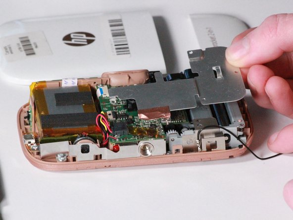

  8. HP Sprocket 2-in-1 Camera Lens Assembly Replacement, Camera Lens Assembly: crwdns2935265:08crwdnd2935265:01crwdnd2935265:02crwdne2935265:0 HP Sprocket 2-in-1 Camera Lens Assembly Replacement, Camera Lens Assembly: crwdns2935265:08crwdnd2935265:02crwdnd2935265:02crwdne2935265:0
    • Use the Japanese Industrial Standard J00 screwdriver to remove five 2.5mm screws.
    • One of the screws is below bronze tape. Move the tape slightly to get to the screw.
    • Remove the metal plate from the casing.
  9. HP Sprocket 2-in-1 Camera Lens Assembly Replacement: crwdns2935265:09crwdnd2935265:01crwdnd2935265:01crwdne2935265:0
    • Use an iFixit opening tool to pry the camera free from the device.
