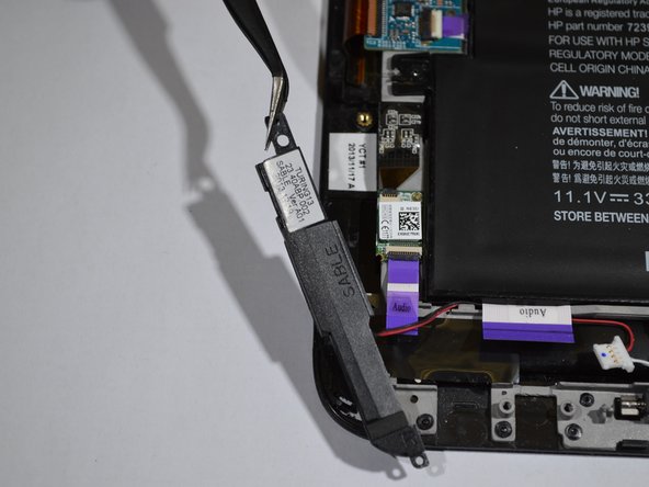

  16. HP Split x2 13-g210dx Speakers Replacement, Speakers: crwdns2935265:016crwdnd2935265:01crwdnd2935265:02crwdne2935265:0 HP Split x2 13-g210dx Speakers Replacement, Speakers: crwdns2935265:016crwdnd2935265:02crwdnd2935265:02crwdne2935265:0
    • Remove the 4-mm Phillips #0 screw.
    • Lift the left speaker away from the device.
  17. HP Split x2 13-g210dx Speakers Replacement: crwdns2935265:017crwdnd2935265:01crwdnd2935265:02crwdne2935265:0 HP Split x2 13-g210dx Speakers Replacement: crwdns2935265:017crwdnd2935265:02crwdnd2935265:02crwdne2935265:0
    • Remove the 4-mm Phillips #0 screw from the same location as found on the left speaker.
    • Lift the right speaker away from the device.

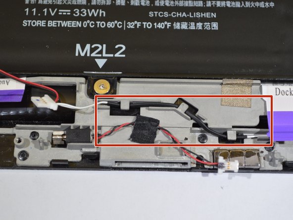

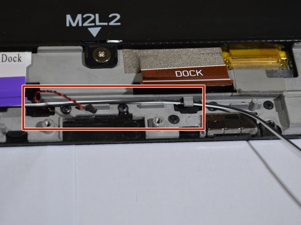

  18. HP Split x2 13-g210dx Speakers Replacement: crwdns2935265:018crwdnd2935265:01crwdnd2935265:03crwdne2935265:0 HP Split x2 13-g210dx Speakers Replacement: crwdns2935265:018crwdnd2935265:02crwdnd2935265:03crwdne2935265:0 HP Split x2 13-g210dx Speakers Replacement: crwdns2935265:018crwdnd2935265:03crwdnd2935265:03crwdne2935265:0
    • Carefully remove the bonded white and black speaker wires running along the bottom of the control board from the fastening clips.
    • Lift the speaker assembly away from the device.
