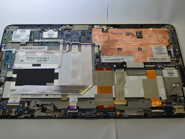

    • Carefully peel off the felt cover that is found beneath the display along the bottom of the device.
    • Use a spudger to gently scrape away the padding that hides the screws in each of the four locations.
    • Remove the four 4-mm Phillips #0 screws.
    • Run a spudger along the crease of the entire laptop and slowly pry off the back panel of the device, beginning with the bottom edge.
    • You will hear popping noises as the clips separate from each other.
  2. HP Split x2 13-g210dx Battery Replacement, Battery: crwdns2935265:02crwdnd2935265:01crwdnd2935265:01crwdne2935265:0
    • Remove the three 6-mm Phillips #0 screws.
  3. HP Split x2 13-g210dx Battery Replacement: crwdns2935265:03crwdnd2935265:01crwdnd2935265:02crwdne2935265:0 HP Split x2 13-g210dx Battery Replacement: crwdns2935265:03crwdnd2935265:02crwdnd2935265:02crwdne2935265:0
    • Remove the white connector clip from the connector port using a sturdy tweezers.
  4. HP Split x2 13-g210dx Battery Replacement: crwdns2935265:04crwdnd2935265:01crwdnd2935265:02crwdne2935265:0 HP Split x2 13-g210dx Battery Replacement: crwdns2935265:04crwdnd2935265:02crwdnd2935265:02crwdne2935265:0
    • Lift the battery away from the device.
