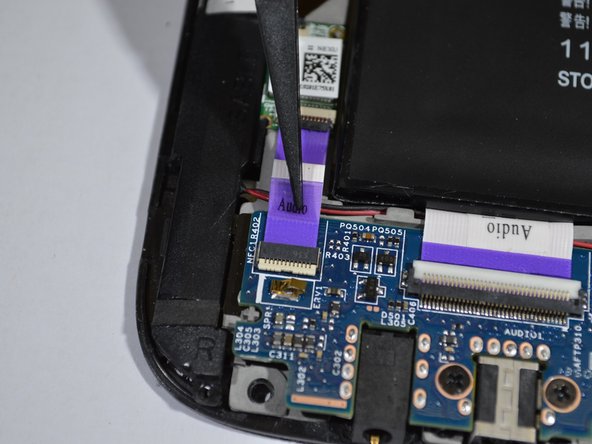

  5. HP Split x2 13-g210dx Audio Ports Replacement, Audio Port: crwdns2935265:05crwdnd2935265:01crwdnd2935265:01crwdne2935265:0
    • Remove the two 4-mm Phillips #0 screws.
  6. HP Split x2 13-g210dx Audio Ports Replacement: crwdns2935265:06crwdnd2935265:01crwdnd2935265:03crwdne2935265:0 HP Split x2 13-g210dx Audio Ports Replacement: crwdns2935265:06crwdnd2935265:02crwdnd2935265:03crwdne2935265:0 HP Split x2 13-g210dx Audio Ports Replacement: crwdns2935265:06crwdnd2935265:03crwdnd2935265:03crwdne2935265:0

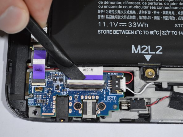

    • Remove the two purple ribbons labeled "Audio" at the top of the audio port board using tweezers or a sturdy plastic opening tool.

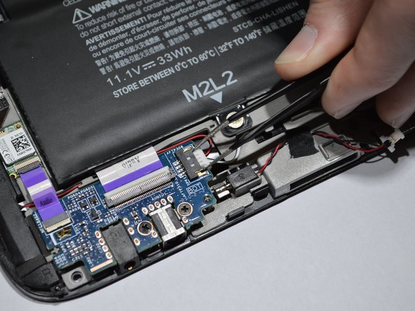

  7. HP Split x2 13-g210dx Audio Ports Replacement: crwdns2935265:07crwdnd2935265:01crwdnd2935265:02crwdne2935265:0 HP Split x2 13-g210dx Audio Ports Replacement: crwdns2935265:07crwdnd2935265:02crwdnd2935265:02crwdne2935265:0
    • Remove the white clip at the top right corner of the audio port board using tweezers.
  8. HP Split x2 13-g210dx Audio Ports Replacement: crwdns2935265:08crwdnd2935265:01crwdnd2935265:01crwdne2935265:0
    • Lift the Audio port away from the device.
