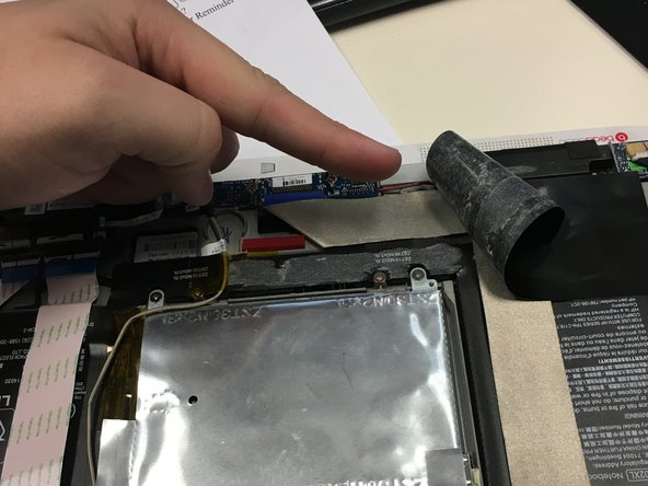

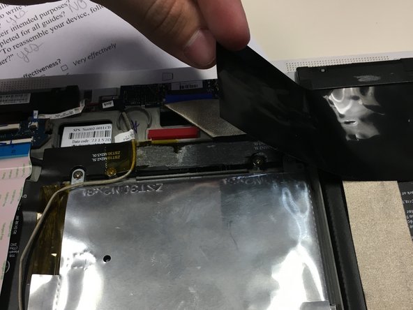

    • Locate the black strip of thermal resistant tape that is covering the upper right portion of the hard drive.
    • Gently lift up with the tape.
    • Fold the tape back away from the hard drive.
