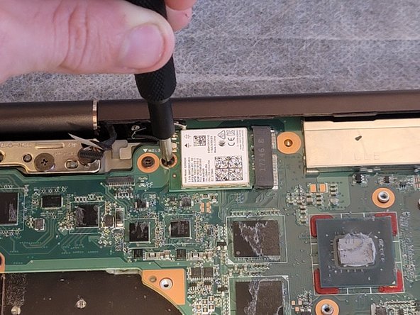

    • Use a Phillips #1 screwdriver to remove the 2 mm screw from the Wi-Fi card that secures it to the motherboard.
    • Slide the Wi-Fi card out of the slot.

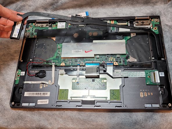

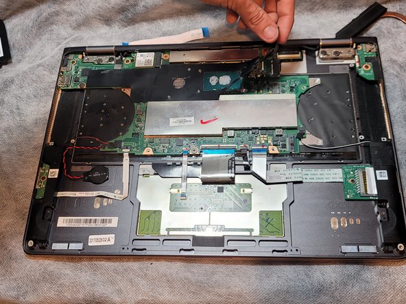

    • Snake the speaker wires out of the plastic routings on the fans that hold the wires in place.
    • Lift the fans and heat sink out.
    • Remove the black heat shield under the heat sink.
  16. HP Spectre x360 15-bl012dx Motherboard Replacement: crwdns2935265:016crwdnd2935265:01crwdnd2935265:03crwdne2935265:0 HP Spectre x360 15-bl012dx Motherboard Replacement: crwdns2935265:016crwdnd2935265:02crwdnd2935265:03crwdne2935265:0 HP Spectre x360 15-bl012dx Motherboard Replacement: crwdns2935265:016crwdnd2935265:03crwdnd2935265:03crwdne2935265:0

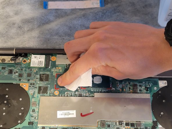

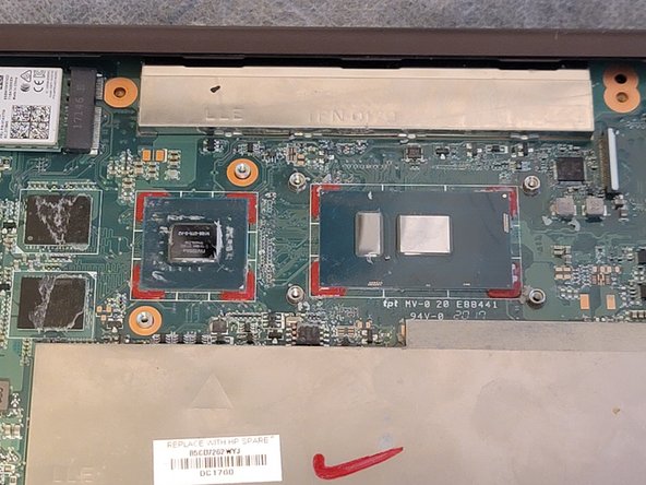

    • Clean the old thermal paste off of the heat sink, cpu, and gpu using isopropyl alcohol and a paper towel. The higher the percentage of the alcohol, the better. I used 91%.
    • Remember to apply thermal paste before installing the new motherboard with fresh thermal paste! A pea sized amount is plenty.
