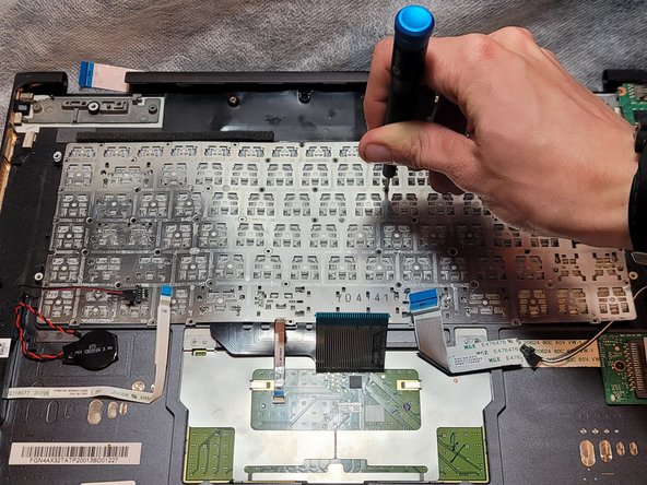

  21. HP Spectre x360 15-bl012dx Keyboard Replacement, Keyboard: crwdns2935265:021crwdnd2935265:01crwdnd2935265:03crwdne2935265:0 HP Spectre x360 15-bl012dx Keyboard Replacement, Keyboard: crwdns2935265:021crwdnd2935265:02crwdnd2935265:03crwdne2935265:0 HP Spectre x360 15-bl012dx Keyboard Replacement, Keyboard: crwdns2935265:021crwdnd2935265:03crwdnd2935265:03crwdne2935265:0
    • Use a Phillips #00 screwdriver to remove sixteen 2 mm screws from the two metal plates on the back of the keyboard.
    • Remove the metal plates.
  22. HP Spectre x360 15-bl012dx Keyboard Replacement: crwdns2935265:022crwdnd2935265:01crwdnd2935265:02crwdne2935265:0 HP Spectre x360 15-bl012dx Keyboard Replacement: crwdns2935265:022crwdnd2935265:02crwdnd2935265:02crwdne2935265:0

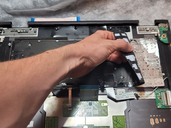

    • Use a spudger to get started and remove the black sheet from the back of the keyboard.
  23. HP Spectre x360 15-bl012dx Keyboard Replacement: crwdns2935265:023crwdnd2935265:01crwdnd2935265:03crwdne2935265:0 HP Spectre x360 15-bl012dx Keyboard Replacement: crwdns2935265:023crwdnd2935265:02crwdnd2935265:03crwdne2935265:0 HP Spectre x360 15-bl012dx Keyboard Replacement: crwdns2935265:023crwdnd2935265:03crwdnd2935265:03crwdne2935265:0

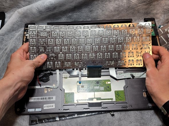

    • Use a Phillips #00 screwdriver to remove the forty-two 2 mm screws from the keyboard and then pull it out from the laptop body.
    • Please note you will have to replace the keyboard with a new one. Reinstalling this keyboard may not function correctly.
