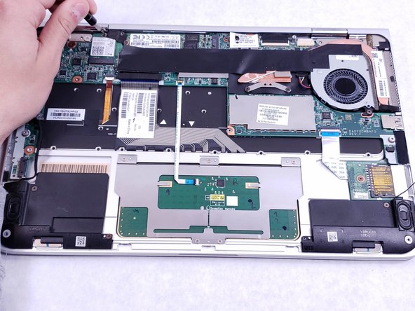

  4. HP Spectre x360 13t-4000 Wifi Adapter Replacement, Battery: crwdns2935265:04crwdnd2935265:01crwdnd2935265:03crwdne2935265:0 HP Spectre x360 13t-4000 Wifi Adapter Replacement, Battery: crwdns2935265:04crwdnd2935265:02crwdnd2935265:03crwdne2935265:0 HP Spectre x360 13t-4000 Wifi Adapter Replacement, Battery: crwdns2935265:04crwdnd2935265:03crwdnd2935265:03crwdne2935265:0
    • With the backplate removed, remove the four 3 mm screws securing the battery with a Phillips #1 screwdriver.
    • With the screws removed, disconnect the 3 wires connected to the battery.
    • Tweezers may be needed to remove the wires.

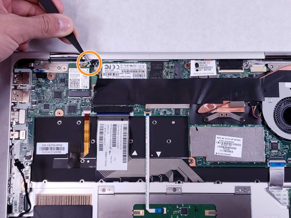

  5. HP Spectre x360 13t-4000 Wifi Adapter Replacement, Wifi Adapter: crwdns2935265:05crwdnd2935265:01crwdnd2935265:03crwdne2935265:0 HP Spectre x360 13t-4000 Wifi Adapter Replacement, Wifi Adapter: crwdns2935265:05crwdnd2935265:02crwdnd2935265:03crwdne2935265:0 HP Spectre x360 13t-4000 Wifi Adapter Replacement, Wifi Adapter: crwdns2935265:05crwdnd2935265:03crwdnd2935265:03crwdne2935265:0
    • Using a Phillips#0 screwdriver, remove the 2 mm screw.
    • Located to the right of the screw, there are two wires connected to the adapter. Using tweezers, carefully remove the wires.
    • There may be tape covering the wires.
    • Now you can remove the adapter by pulling it from its socket.
