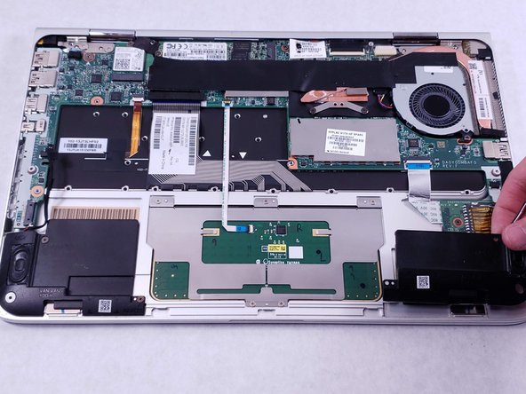

    • Insert an opening tool under the bottom cover at the screen hinges, and gently pry the cover free.
    • Carefully work your way around the cover's edges to pop it off completely.

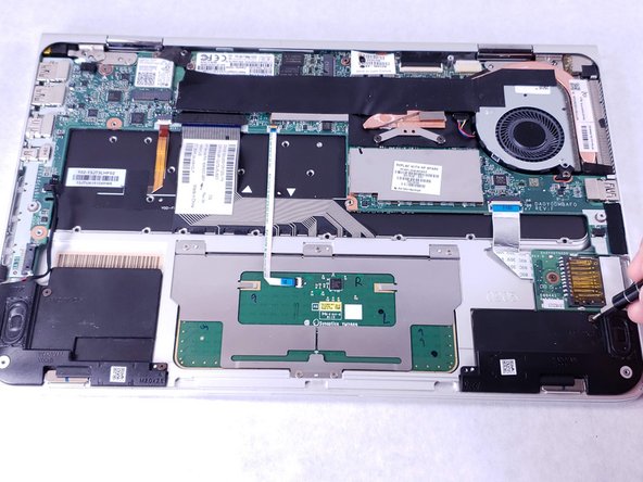

  5. HP Spectre x360 13t-4000 Speakers Replacement, Speakers: crwdns2935265:05crwdnd2935265:01crwdnd2935265:03crwdne2935265:0 HP Spectre x360 13t-4000 Speakers Replacement, Speakers: crwdns2935265:05crwdnd2935265:02crwdnd2935265:03crwdne2935265:0 HP Spectre x360 13t-4000 Speakers Replacement, Speakers: crwdns2935265:05crwdnd2935265:03crwdnd2935265:03crwdne2935265:0
    • With the backplate and battery removed from the device, remove the three 2mm screws using the Phillips #0 screwdriver.

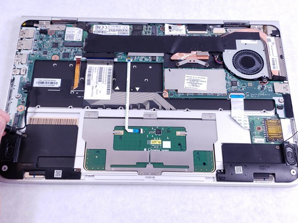

  6. HP Spectre x360 13t-4000 Speakers Replacement: crwdns2935265:06crwdnd2935265:01crwdnd2935265:02crwdne2935265:0 HP Spectre x360 13t-4000 Speakers Replacement: crwdns2935265:06crwdnd2935265:02crwdnd2935265:02crwdne2935265:0
    • With all three screws removed, remove the speaker assembly from the device.
