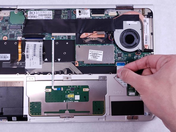

  5. HP Spectre x360 13t-4000 SD Card Reader Replacement, SD Card Reader: crwdns2935265:05crwdnd2935265:01crwdnd2935265:02crwdne2935265:0 HP Spectre x360 13t-4000 SD Card Reader Replacement, SD Card Reader: crwdns2935265:05crwdnd2935265:02crwdnd2935265:02crwdne2935265:0
    • Remove the 2 mm long Phillips #000 head screw on the SD Card Reader.
    • Using a plastic spudger, release the pressure connector marked with the green rectangle by gently prying up from below.
    • Once the pressure connector is undone, the white ribbon cable connected to the SD Card Reader will pull out with no resistance.
    • With the ribbon cable disconnected and the screw out, the SD Card Reader will be free to remove and replace.
    • When replacing the SD Card Reader, ensure the ribbon cable is firmly secured in the pressure connector, with the metal contact points facing down towards the motherboard.
