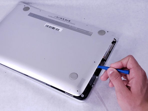

  3. HP Spectre x360 13t-4000 Hard Drive Replacement: crwdns2935265:03crwdnd2935265:01crwdnd2935265:03crwdne2935265:0 HP Spectre x360 13t-4000 Hard Drive Replacement: crwdns2935265:03crwdnd2935265:02crwdnd2935265:03crwdne2935265:0 HP Spectre x360 13t-4000 Hard Drive Replacement: crwdns2935265:03crwdnd2935265:03crwdnd2935265:03crwdne2935265:0
    • Insert an opening tool under the bottom cover at the screen hinges, and gently pry the cover free.
    • Carefully work your way around the cover's edges to pop it off completely.
