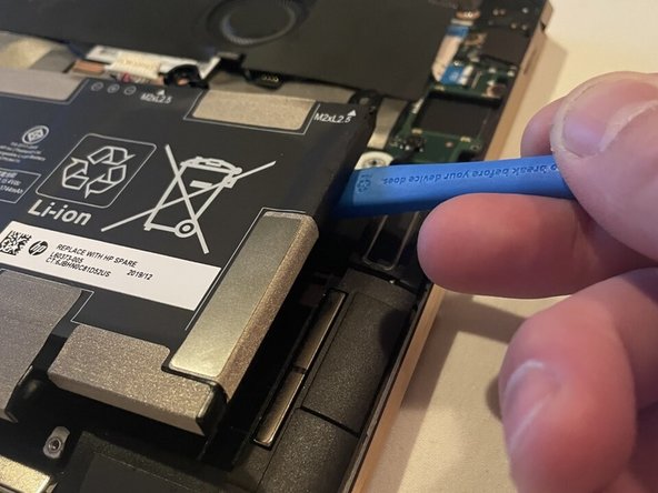

    • Use two opening tools, one on either side of the battery plug, to slowly pull the plug straight out of its port.
    • Alternatively, use your fingernails.
  2. HP Spectre x360 13-aw0xxx Speaker Replacement: crwdns2935265:02crwdnd2935265:01crwdnd2935265:02crwdne2935265:0 HP Spectre x360 13-aw0xxx Speaker Replacement: crwdns2935265:02crwdnd2935265:02crwdnd2935265:02crwdne2935265:0
    • Use a Phillips #00 screwdriver to remove the six 2.5 mm screws securing the battery.
  3. HP Spectre x360 13-aw0xxx Speaker Replacement: crwdns2935265:03crwdnd2935265:01crwdnd2935265:02crwdne2935265:0 HP Spectre x360 13-aw0xxx Speaker Replacement: crwdns2935265:03crwdnd2935265:02crwdnd2935265:02crwdne2935265:0
    • Carefully lift the edge of the battery with an opening tool.
    • Lift the battery up and out.

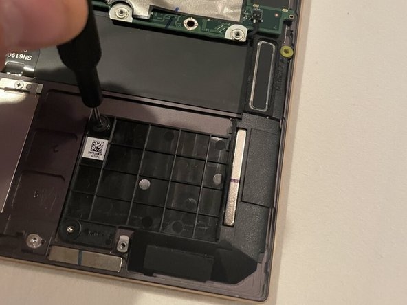

  4. HP Spectre x360 13-aw0xxx Speaker Replacement, Speaker: crwdns2935265:04crwdnd2935265:01crwdnd2935265:02crwdne2935265:0 HP Spectre x360 13-aw0xxx Speaker Replacement, Speaker: crwdns2935265:04crwdnd2935265:02crwdnd2935265:02crwdne2935265:0
    • Remove the 3 mm Phillips screws on the speaker(s) you wish to replace.

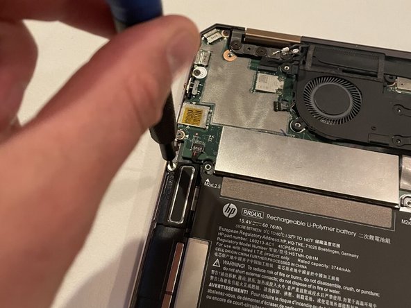

  5. HP Spectre x360 13-aw0xxx Speaker Replacement: crwdns2935265:05crwdnd2935265:01crwdnd2935265:02crwdne2935265:0 HP Spectre x360 13-aw0xxx Speaker Replacement: crwdns2935265:05crwdnd2935265:02crwdnd2935265:02crwdne2935265:0
    • Remove the two 2 mm Phillips #00 screws located under the battery.
    • Repeat for the other speaker if necessary.

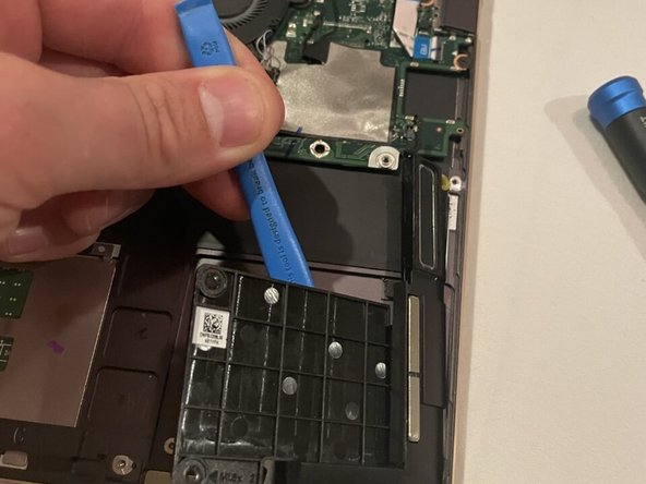

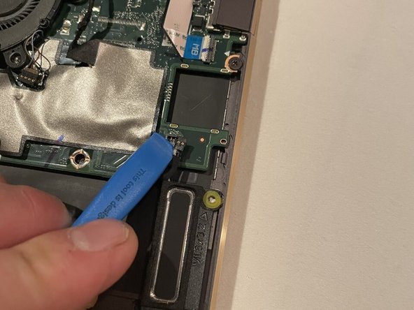

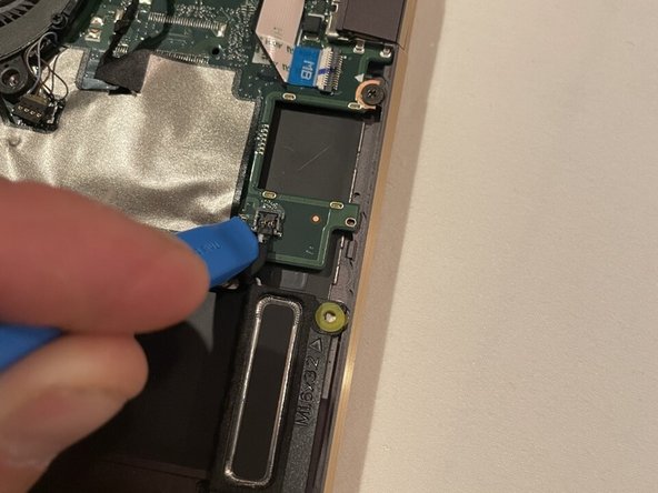

    • Use a small pry tool to lift up and disconnect the speaker cable from the motherboard.
  7. HP Spectre x360 13-aw0xxx Speaker Replacement: crwdns2935265:07crwdnd2935265:01crwdnd2935265:02crwdne2935265:0 HP Spectre x360 13-aw0xxx Speaker Replacement: crwdns2935265:07crwdnd2935265:02crwdnd2935265:02crwdne2935265:0
    • Using the same pry tool lift up on the speaker housing and remove it.
