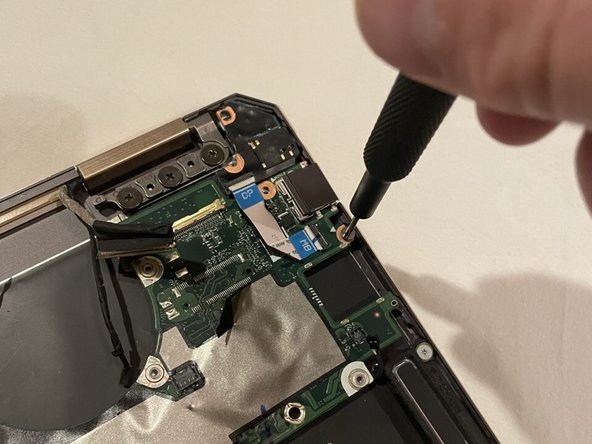

    • Remove the eight 3 mm screws securing the motherboard using a Phillips #00 screwdriver.

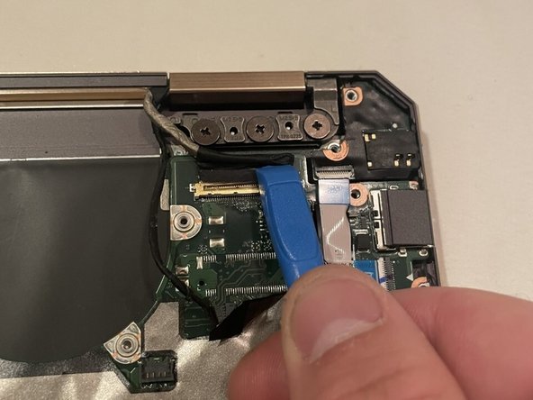

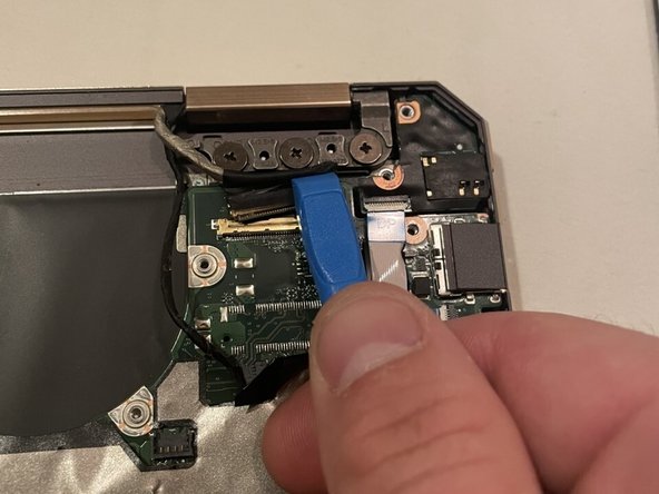

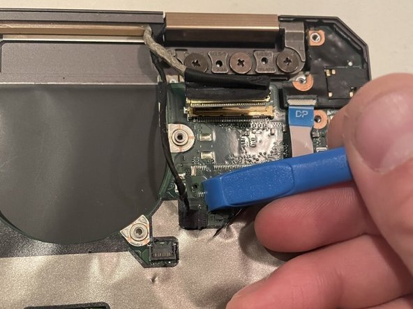

    • Disconnect the display cable from the motherboard using a small pry tool.
  11. HP Spectre x360 13-aw0xxx Charging Port Replacement: crwdns2935265:011crwdnd2935265:01crwdnd2935265:03crwdne2935265:0 HP Spectre x360 13-aw0xxx Charging Port Replacement: crwdns2935265:011crwdnd2935265:02crwdnd2935265:03crwdne2935265:0 HP Spectre x360 13-aw0xxx Charging Port Replacement: crwdns2935265:011crwdnd2935265:03crwdnd2935265:03crwdne2935265:0

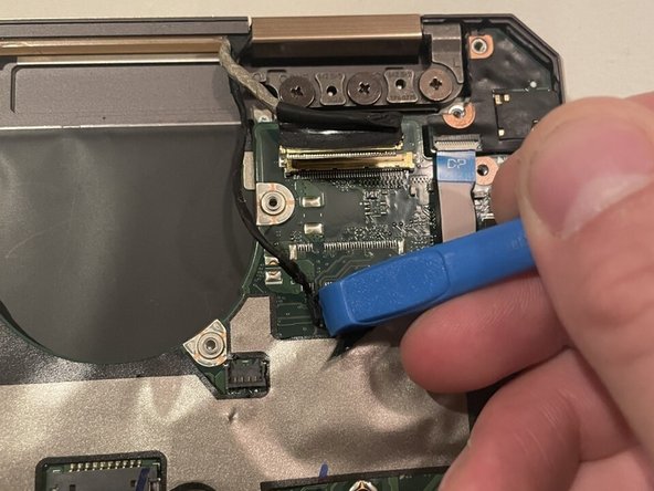

    • Disconnect the smaller flip screen sensor cable from the motherboard.

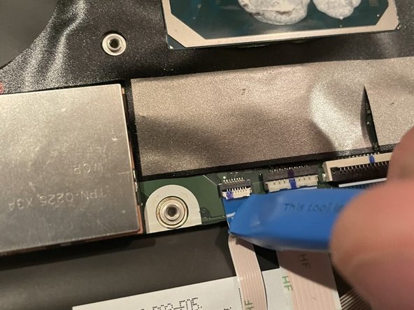

  12. HP Spectre x360 13-aw0xxx Charging Port Replacement: crwdns2935265:012crwdnd2935265:01crwdnd2935265:03crwdne2935265:0 HP Spectre x360 13-aw0xxx Charging Port Replacement: crwdns2935265:012crwdnd2935265:02crwdnd2935265:03crwdne2935265:0 HP Spectre x360 13-aw0xxx Charging Port Replacement: crwdns2935265:012crwdnd2935265:03crwdnd2935265:03crwdne2935265:0

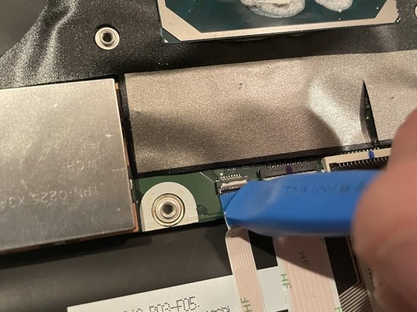

    • Flip the ZIF connector lock bars up to release the ribbon cables.
    • Remove the ribbon cables.

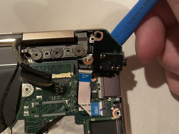

  13. HP Spectre x360 13-aw0xxx Charging Port Replacement: crwdns2935265:013crwdnd2935265:01crwdnd2935265:02crwdne2935265:0 HP Spectre x360 13-aw0xxx Charging Port Replacement: crwdns2935265:013crwdnd2935265:02crwdnd2935265:02crwdne2935265:0

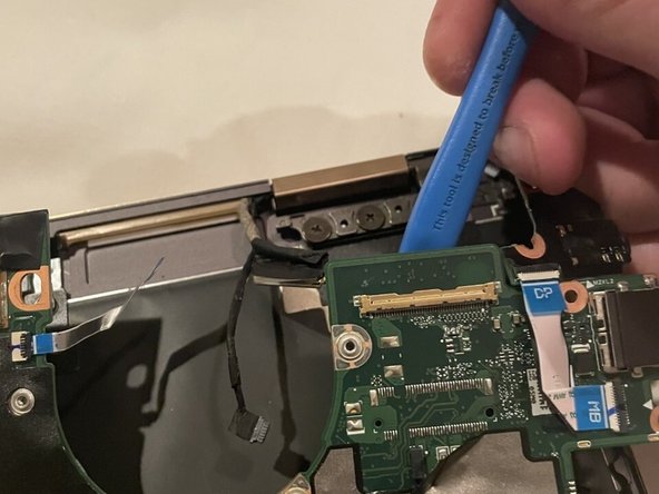

    • Start removing the I/O board by removing the piece in the upper right corner (opposite the charging port side).
    • Use a small opening tool to remove up the I/O board from the body.
  14. HP Spectre x360 13-aw0xxx Charging Port Replacement: crwdns2935265:014crwdnd2935265:01crwdnd2935265:02crwdne2935265:0 HP Spectre x360 13-aw0xxx Charging Port Replacement: crwdns2935265:014crwdnd2935265:02crwdnd2935265:02crwdne2935265:0
    • Using a small pry tool lift up on the larger portion of the motherboard to remove it from the body of the laptop.
    • The motherboard will be free from the laptop body and the new charging port and motherboard can be inserted.
