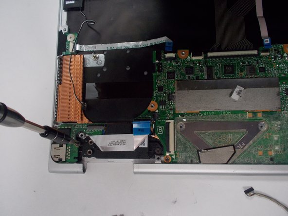

  6. HP Spectre x360 13-ac023dx Motherboard Replacement: crwdns2935265:06crwdnd2935265:01crwdnd2935265:01crwdne2935265:0
    • Remove the Cooling Fan.

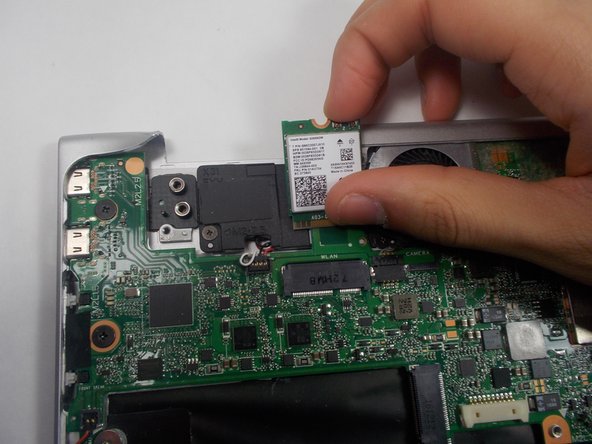

  7. HP Spectre x360 13-ac023dx Motherboard Replacement, WiFi Card: crwdns2935265:07crwdnd2935265:01crwdnd2935265:01crwdne2935265:0
    • Locate the WiFi card in the top left of the motherboard.
  8. HP Spectre x360 13-ac023dx Motherboard Replacement: crwdns2935265:08crwdnd2935265:01crwdnd2935265:01crwdne2935265:0
    • Use the Phillips #000 screwdriver to remove the screw holding the wifi card in place.
  9. HP Spectre x360 13-ac023dx Motherboard Replacement: crwdns2935265:09crwdnd2935265:01crwdnd2935265:02crwdne2935265:0 HP Spectre x360 13-ac023dx Motherboard Replacement: crwdns2935265:09crwdnd2935265:02crwdnd2935265:02crwdne2935265:0
    • Once the screw is removed, hold the WiFi card by it's sides and raise it up whiling sliding it out from the slot.
  10. HP Spectre x360 13-ac023dx Motherboard Replacement: crwdns2935265:010crwdnd2935265:01crwdnd2935265:01crwdne2935265:0
    • After removing the Wifi card, place the card within a static dissipative bag.
  11. HP Spectre x360 13-ac023dx Motherboard Replacement: crwdns2935265:011crwdnd2935265:01crwdnd2935265:01crwdne2935265:0
    • Hold the replacement Wifi card by the edges and remove it out of the static-dissipative bag.
  12. HP Spectre x360 13-ac023dx Motherboard Replacement: crwdns2935265:012crwdnd2935265:01crwdnd2935265:01crwdne2935265:0
    • Align the notches on the Wifi card with the keys on the Wifi card slot.
    • Hold the card by the edges and slide the Wifi card into the Wifi Card slot.

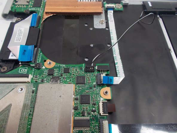

  15. HP Spectre x360 13-ac023dx Motherboard Replacement: crwdns2935265:015crwdnd2935265:01crwdnd2935265:03crwdne2935265:0 HP Spectre x360 13-ac023dx Motherboard Replacement: crwdns2935265:015crwdnd2935265:02crwdnd2935265:03crwdne2935265:0 HP Spectre x360 13-ac023dx Motherboard Replacement: crwdns2935265:015crwdnd2935265:03crwdnd2935265:03crwdne2935265:0
    • Disconnect the wires which connect the motherboard to the rest of the components.
    • The black and red wire can be removed by pulling the wire upwards.

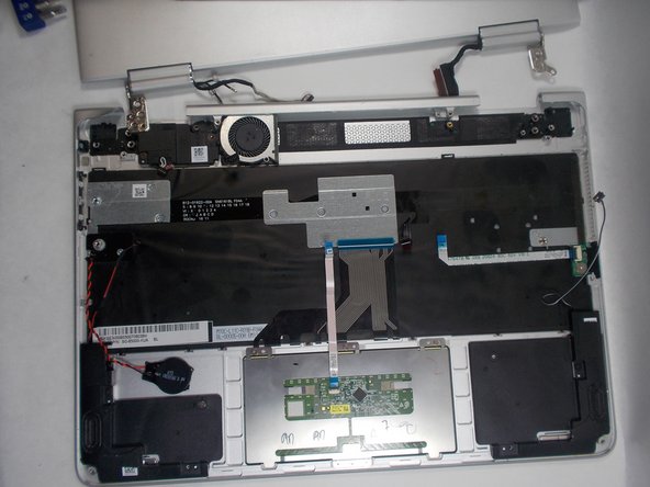

  16. HP Spectre x360 13-ac023dx Motherboard Replacement: crwdns2935265:016crwdnd2935265:01crwdnd2935265:03crwdne2935265:0 HP Spectre x360 13-ac023dx Motherboard Replacement: crwdns2935265:016crwdnd2935265:02crwdnd2935265:03crwdne2935265:0 HP Spectre x360 13-ac023dx Motherboard Replacement: crwdns2935265:016crwdnd2935265:03crwdnd2935265:03crwdne2935265:0
    • Use the Phillips #000 screwdriver to remove the three 3.5 mm screws which keep the motherboard in place.
  17. HP Spectre x360 13-ac023dx Motherboard Replacement: crwdns2935265:017crwdnd2935265:01crwdnd2935265:02crwdne2935265:0 HP Spectre x360 13-ac023dx Motherboard Replacement: crwdns2935265:017crwdnd2935265:02crwdnd2935265:02crwdne2935265:0
    • Carefully lift and remove the motherboard.
