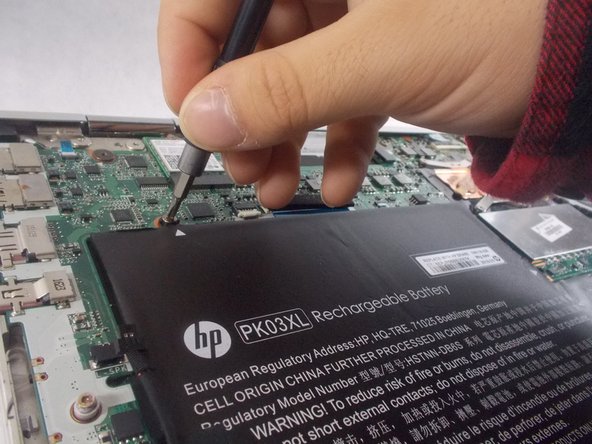

  4. HP Spectre x360 13-4103dx Touch Pad Replacement, Battery: crwdns2935265:04crwdnd2935265:01crwdnd2935265:02crwdne2935265:0 HP Spectre x360 13-4103dx Touch Pad Replacement, Battery: crwdns2935265:04crwdnd2935265:02crwdnd2935265:02crwdne2935265:0
    • Remove the four screws from the battery using a Phillips #0 screwdriver.
  5. HP Spectre x360 13-4103dx Touch Pad Replacement: crwdns2935265:05crwdnd2935265:01crwdnd2935265:01crwdne2935265:0
    • Remove the battery from the computer.

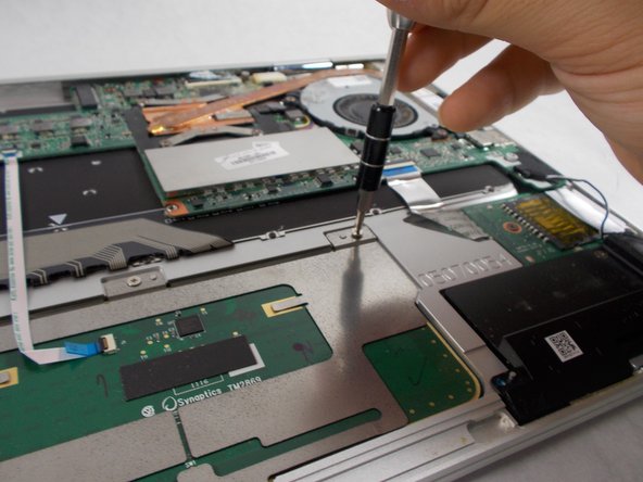

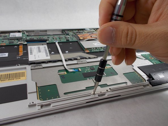

  6. HP Spectre x360 13-4103dx Touch Pad Replacement, Touch Pad: crwdns2935265:06crwdnd2935265:01crwdnd2935265:03crwdne2935265:0 HP Spectre x360 13-4103dx Touch Pad Replacement, Touch Pad: crwdns2935265:06crwdnd2935265:02crwdnd2935265:03crwdne2935265:0 HP Spectre x360 13-4103dx Touch Pad Replacement, Touch Pad: crwdns2935265:06crwdnd2935265:03crwdnd2935265:03crwdne2935265:0
    • Remove the five screws from the trackpad using a Phillips #0 screwdriver.
  7. HP Spectre x360 13-4103dx Touch Pad Replacement: crwdns2935265:07crwdnd2935265:01crwdnd2935265:01crwdne2935265:0
    • Gently unplug the ribbon cable that is attached to the computer.
  8. HP Spectre x360 13-4103dx Touch Pad Replacement: crwdns2935265:08crwdnd2935265:01crwdnd2935265:01crwdne2935265:0
    • Remove the touchpad from the computer.
