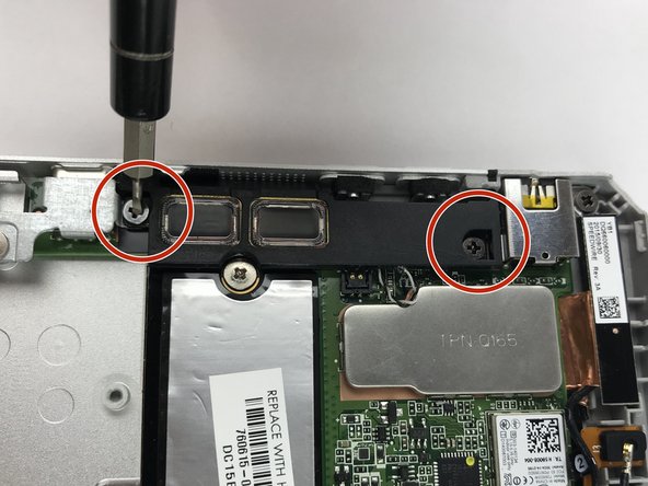

  5. HP Spectre x2 12-a002dx Speaker Replacement, Speaker: crwdns2935265:06crwdnd2935265:01crwdnd2935265:01crwdne2935265:0
    • The HP Spectre x2 has Two Speakers at the top of the laptop on either end.
  6. HP Spectre x2 12-a002dx Speaker Replacement: crwdns2935265:07crwdnd2935265:01crwdnd2935265:02crwdne2935265:0 HP Spectre x2 12-a002dx Speaker Replacement: crwdns2935265:07crwdnd2935265:02crwdnd2935265:02crwdne2935265:0
    • Unscrew the speaker assemblies.
    • Each speaker has two PM2.0×3.4 screws securing the speakers as shown. Use a Phillips #0 to unscrew all four screws
