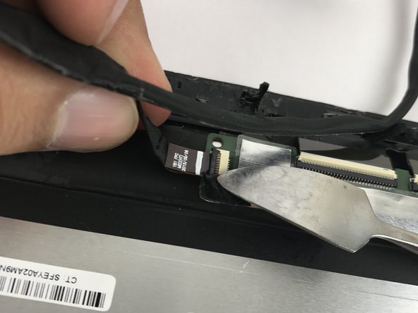

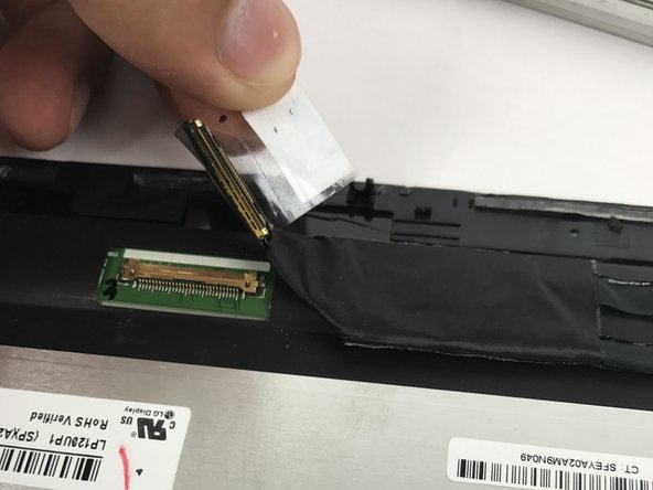

  4. HP Spectre x2 12-a002dx Screen Replacement: crwdns2935265:05crwdnd2935265:01crwdnd2935265:03crwdne2935265:0 HP Spectre x2 12-a002dx Screen Replacement: crwdns2935265:05crwdnd2935265:02crwdnd2935265:03crwdne2935265:0 HP Spectre x2 12-a002dx Screen Replacement: crwdns2935265:05crwdnd2935265:03crwdnd2935265:03crwdne2935265:0
    • Remove the connecting cable of the screen and battery. Use a spudger to reveal the adhesive strip and carefully peel it off.
    • Insert a spudger to the other end and release the ZIF connectors. Detach the cable.
    • While a metal spudger is pictured, use a black nylon spudger instead because it is ESD safe.
