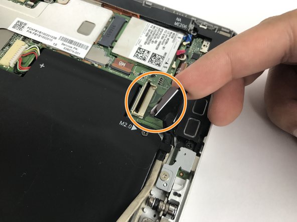

    • Remove the connecting cable of the screen and battery. Use a spudger to reveal the adhesive strip and carefully peel it off.
    • Insert a spudger to the other end and release the ZIF connectors. Detach the cable.
    • While a metal spudger is pictured, use a black nylon spudger instead because it is ESD safe.

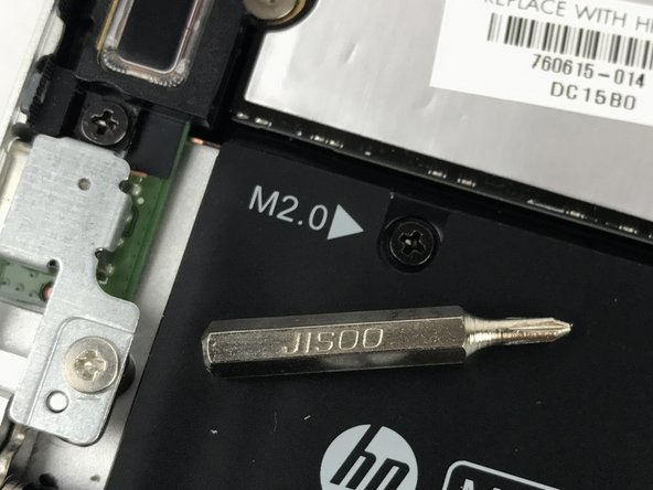

    • Remove the six Phillips M2.0×3.5 screws connecting the battery to the device using the JIS 00 screwdriver.
    • Make sure to keep the screws in a safe place. You will need to use them to secure the replacement battery back in place.

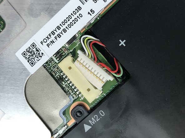

    • Use the tip of a spudger to push the battery connector out of its socket.
    • It helps to "walk" the connector out by pressing first on one side, then the other.

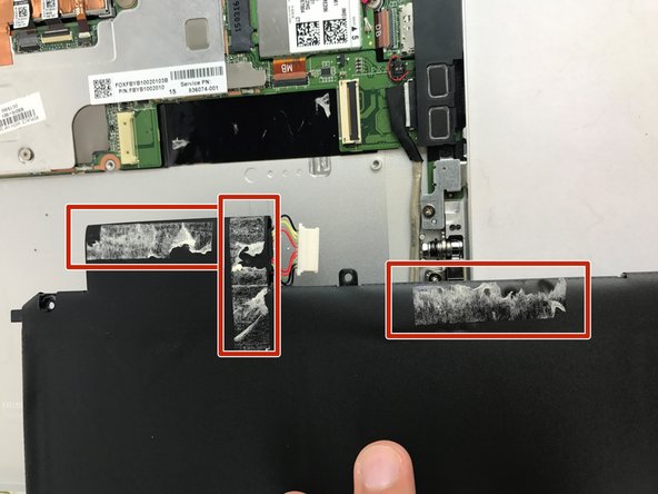

    • Lift up the side of the battery that isn't glued down with adhesive
    • Use the spatula to gently scrape away the adhesive while applying a gentle upward pressure to help break the adhesive bonds.
    • A metal spudger was used again as pictured, but the black nylon spudger would be more appropriate to use.
