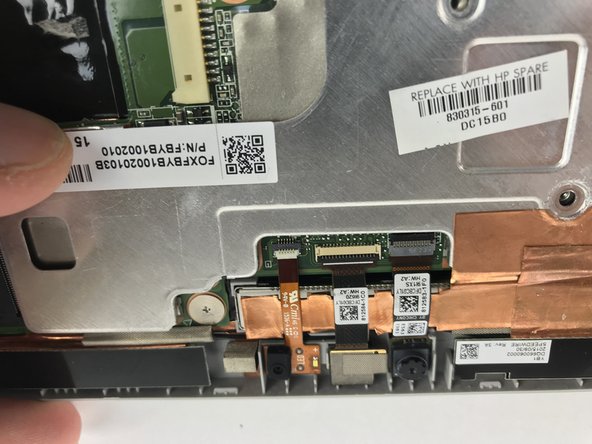

  5. HP Spectre x2 12-a002dx Back Camera Replacement, Back Camera: crwdns2935265:06crwdnd2935265:01crwdnd2935265:01crwdne2935265:0
    • The HP Spectre X2 Has three Cameras: A front facing webcam( blue arrow), a rear Facing webcam (orange arrow), and a 3d camera (red box). The 3d camera is covered by tape that connects to the heat sink.
  6. HP Spectre x2 12-a002dx Back Camera Replacement: crwdns2935265:07crwdnd2935265:01crwdnd2935265:01crwdne2935265:0
    • Begin by removing the ribbon that connects the front facing webcam to the motherboard. You can use a black nylon spudger as pictured to do this.

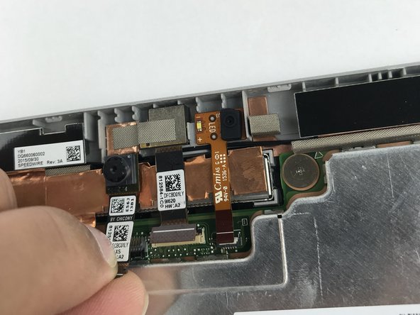

  7. HP Spectre x2 12-a002dx Back Camera Replacement: crwdns2935265:08crwdnd2935265:01crwdnd2935265:02crwdne2935265:0 HP Spectre x2 12-a002dx Back Camera Replacement: crwdns2935265:08crwdnd2935265:02crwdnd2935265:02crwdne2935265:0
    • The Front facing webcam is secured to the HP spectre by the laptop frame and adhesive on the ribbon cable connecting the camera to the motherboard.
    • To remove the camera, peel back the ribbon cable and then slide the camera down and out of the laptop frame,
  8. HP Spectre x2 12-a002dx Back Camera Replacement: crwdns2935265:09crwdnd2935265:01crwdnd2935265:02crwdne2935265:0 HP Spectre x2 12-a002dx Back Camera Replacement: crwdns2935265:09crwdnd2935265:02crwdnd2935265:02crwdne2935265:0
    • The rear facing webcam is secured in the same manner as the front.
    • Remove the ribbon connecting the camera to the motherboard, and slide the camera down and out of the laptop frame.
  9. HP Spectre x2 12-a002dx Back Camera Replacement: crwdns2935265:010crwdnd2935265:01crwdnd2935265:02crwdne2935265:0 HP Spectre x2 12-a002dx Back Camera Replacement: crwdns2935265:010crwdnd2935265:02crwdnd2935265:02crwdne2935265:0

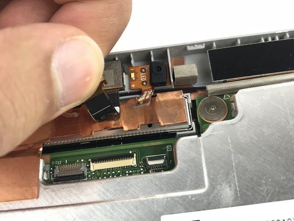

    • Next to the webcam is the Led light.
    • To replace the LED camera light, disconnect the ribbon cable from the motherboard. The LED light should slide freely out of the assembly.
    • The black nylon spudger may be used here again.
